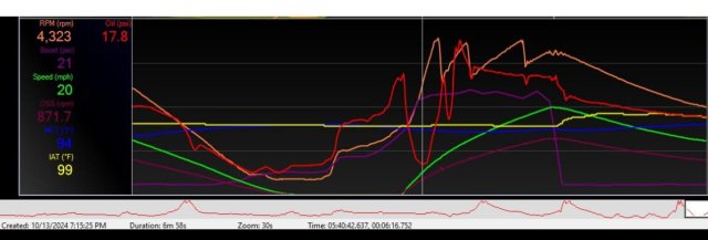

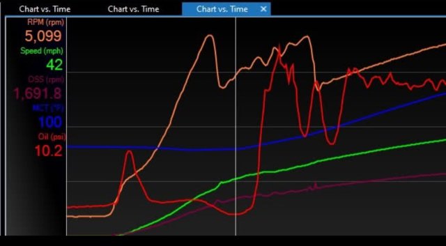

If you drive your car hard this is why you need to add more than what’s called for. Both of these were factory fill levels. This is what will hurt your car…not an extra 1/2 a quart of oil. IMG_7257.jpeg IMG_7258.jpeg

We’ve been building and racing these cars for going on 6 years now. We’ve learned a lot about keeping them alive and no matter what irrelevant YouTube video you post…if an ST is going to be driven hard it needs an extra 1/4-1/2 a quart of oil. The 2 logs I posted above are just two of hundreds of identical cases. 1/2 a quart over stops the oil pressure drop on launches. Your opinion won’t change that fact.

I believe in data driven decisions. 1/2 quart of 6 quarts is less than 10% increase. The graphs that @UNBROKEN shared do show oil starvation during launch.

Those screen shots I posted are from datalogs sent to ZFG. Adam is the one that identified the issue years ago and in the performance groups adding up to 1/2 a quart has become the standard at oil changes. You can find threads from Adam here discussing it as well.

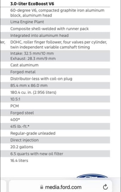

I already said I misremembered on the fill level but they in fact did change the oil pump along with a few other things like turbos, intercooler fittings and associated piping.

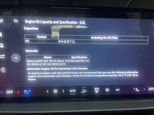

Actually…I remembered just fine. Maybe there’s a discrepancy on Ford websites and/or documents. IMG_7301.jpeg

All opinions aside, I believe Ford still recommends 6 quarts on the 25 model year.
Apparently it depends on what you read. I knew I saw this as one time. IMG_7301.jpeg

My 25 manual says 6.0 quarts. Job 2 build
