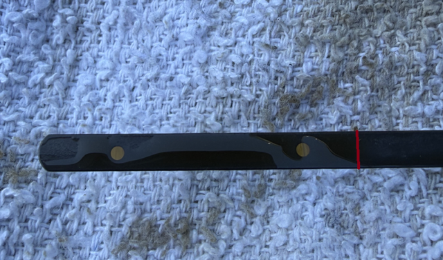

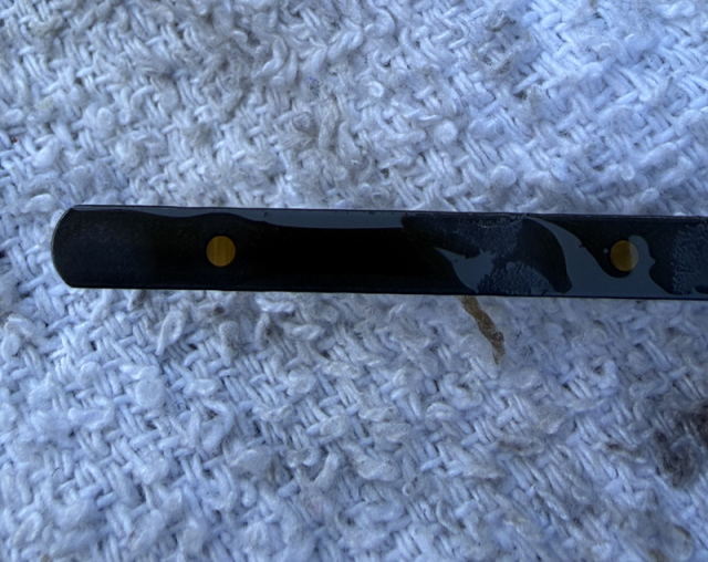

For anyone who is bored. Shop service fill from yesterday, vs me adding a 1/2 qt this morning. The engine sat all night.

Thats where it sat after the factory fill dump and refill after I added a 1/2 qt last time. Never budged for 5300 miles.

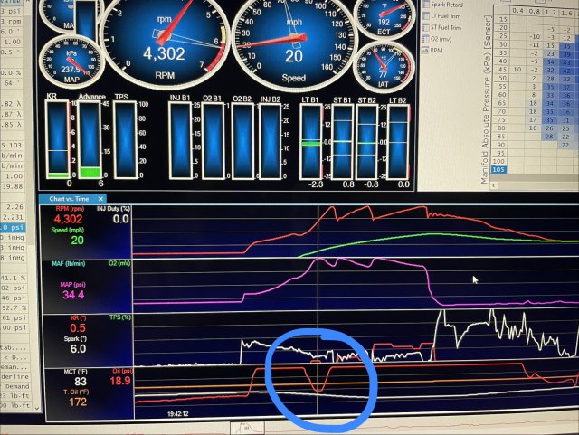

For folks who datalog, what is the typical oil pressure drop on a launch? I did 6.5 qts on my last fill (2020 st) but still seeing 18.9 psi dip around 20mph. This is from a boosted launch running 4.6s 0-60. Wondering if this is worth adding another half quart or if this is just inevitable. Max PSI my datalogs capture is 37psi, is that the sensor max? Seems low still.

Interesting. So it appears a delay in pressure drop after the launch but before the first gear shift? Would make sense, pick up full at launch, slosh then lower pressure before back to pressure before the first gear change. 18psi is not great. I think someone has done 7qts but I am not sure if crank case pressures increase or if oil aeration is an issue with the 3.0 Ecoboost at 7qts (still new to the platform).

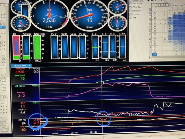

Today I added half a qt to get the oil level closer to the bend on the stick. Then I did a faster 4.3 sec 0-60, and the oil pressure only dropped to 32psi.
This has been discussed over and over but it is cool to see the proof on the screen. Half a quart could really make or break. And important to check often because these do consume a good bit over time.
