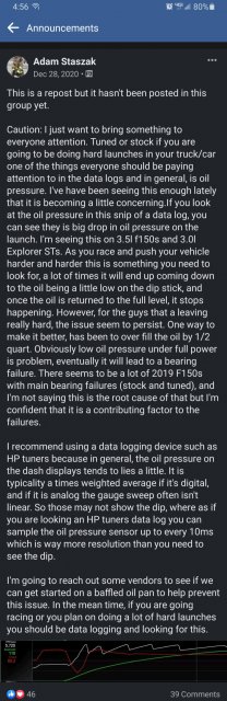

It’s a well known issue when launching that shows as a hard dip in pressure on launch then it recovers. 1/2 a quart over has proven to all but eliminate the issue with no negative effects otherwise.

Here is the post, its a sticky in the High Perf FB page that @UNBROKEN moderates. 20211030_165704.jpg

Problem is the oil pan isn't really the oil pan and the pump is the pickup... I really need to design something here for it but right now keeping the oil at full or a 1/2 qt above seems to be doing okay.

Here is the post, its a sticky in the High Perf FB page that @UNBROKEN moderates. View attachment 8326
