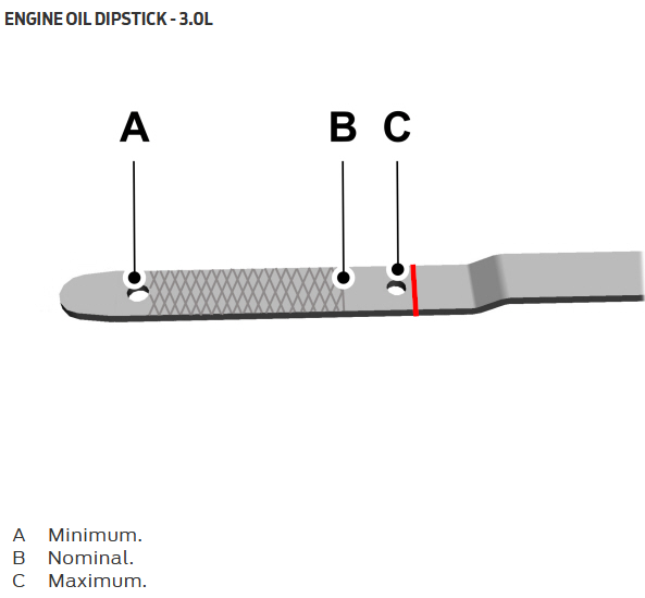

Just completed another oil change this past weekend. This time I got the engine HOT by running errands for a couple hours. Let it drain for 30 minutes to get as much out as possible. Added 6 quarts, no more, no less. After resting overnight, the cold level (red line) has been above the upper circle checking three mornings in a row. After reading up on the wrong dipstick issues with the Broncos, it appears the circle isn't really the maximum on our 3.0 dipsticks. I would imagine if running 6.5qt, the resting oil would be closer the the bend. Just another head scratcher with some of these Ford engineers.

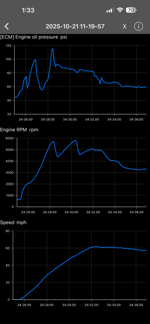

Tuned who? ZFG recommended 6.5 qt.... I have data log with hp tuner with 6 qt and brake launch oil pressure drop to 8 psi with 5w30 with 6.5 qt oil pressure drop to 16 psi...

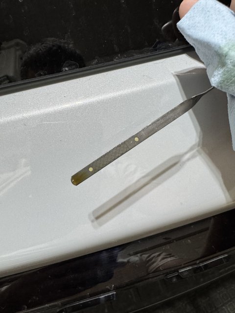

With 6.5 qts of fresh cold oil just put in, car hasnt even been started yet with the new oil. This is where it sits. Right where the bend starts. After driving, getting it up to temp, and shutting it off for 10 mins, it may sit at a different spot. I’ll try to upload a pic of that scenario later.
Also, i used an extractor from the dip stick for all the oil. I wanted to see how much was still in the pan and endure it was empty. so i pulled the drain plug - waste of time. There was maybe a couple ounces if that.
My 2020 consumes quite a bit of oil and builds up in the catch can too. So it’s important to know where 6.5 qts sits since i’m adding oil regularly. I’m trying valvoline restore and protect to see if it can fix the consumption issue. I haven't had the car long so I didn't monitor it closely enough at first but i believe i’m adding 1-2 qts every 5k. Oil pan looks like it needs a gasket too. Doesn't drip though.

The ST user manual says to check the level properly you need to run the engine until it’s at temp. Then shut it off, and wait 10 minutes. And then your oil should be within the cross hatches like you’d expect. Checking it cold will always read high like that. Scared me the first time i saw that.
Agree. Run it, wait 10 minutes or so then check it.

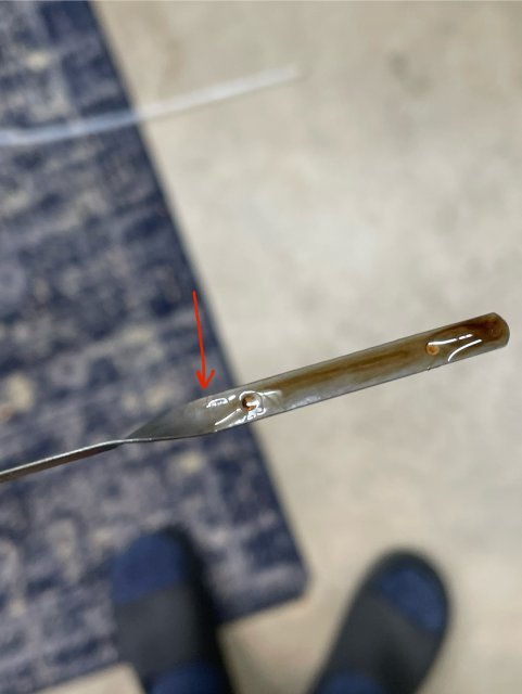

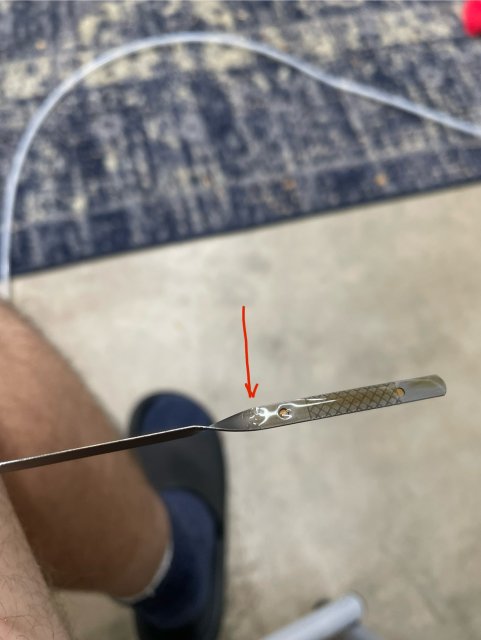

Here’s what I measured after draining our 2025 V6 Platinum on ramps and refilling with exactly 6 quarts of oil.

Drop oil pressure in hard acceleration
