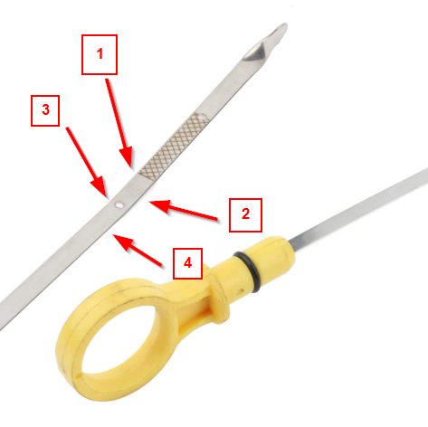

Whether 6qt or 6.25qt or 6.5qt, etc., for those that state the engine requires more than 6qt when running hard, where to you expect to see the oil level when cold after sitting overnight 8+ hrs?
Interesting, manual says the 3 is the max fill level but it goes to 1(Normal) when I just add 6qt, never thought about that. Starts up a lot smoother at 2.

Not sure why you are so angry. I am trying to understand where it is recommended to dial it in if between the hash and upper dot is not what is being recommended or is that what is being recommended. The last time I changed the oil, even after letting it drain for a while, when adding 6qt it was near the 4, which seemed too much. It has happened two times in a row now. I've never had a vehicle, including other Fords in the last thirty years, that the fill didn't match the stick at the top of the hash area. Since folks are saying it should be slightly overfilled, I am looking for a reference spot on the stick so it can be dialed in after sitting overnight, which is how I've measured oil for the last thirty years on over a dozen vehicles. It is a serious and sincere question and I'm sorry it is so upsetting for you.
Mine is at 3 and the dealer said they add about 6.5 quarts.
