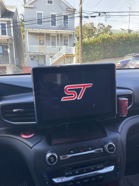

Did the Lincoln screen swap
BigBlue20
New Jersey
2020 Explorer St

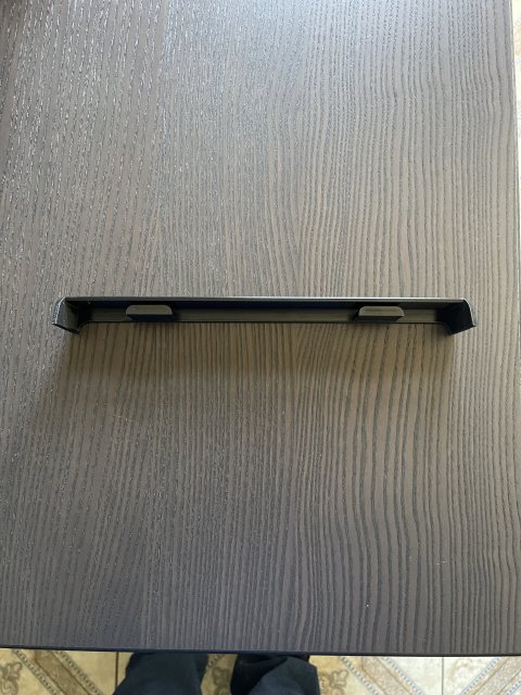

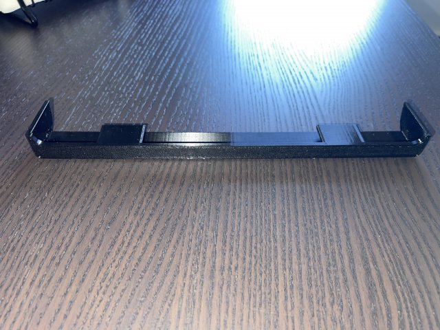

I think I’m gonna go ahead and do this swap. I lover everything about it except for the printed bottom trim people are using. I’ll send the screen to my friends at MTI to fab something more oem looking.

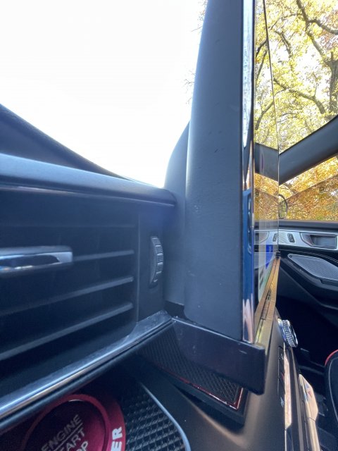

The bottom piece fits good, I mean we are doing a retro fit of something that isn’t supposed to go there is never going to be 100%

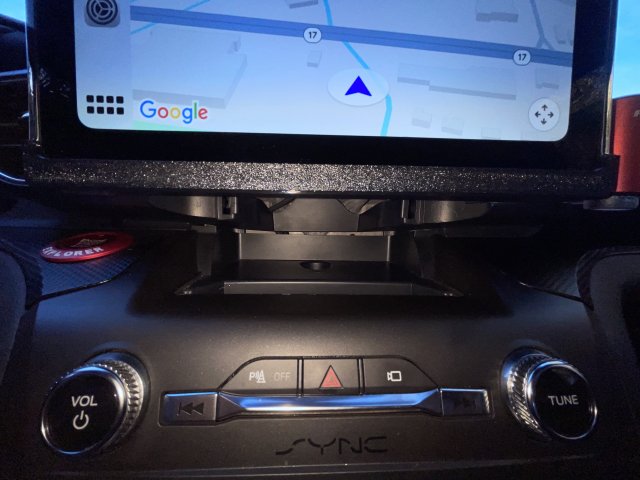

Something like this? When you turn off the car this is what it shows. Now I have a Ford Explorer ST/ Navigator
I think livingitup has a file to fix the l8ncoln thing
Did you try resetting the splash screen in forscan
That set up looks perfect. Great height and everything

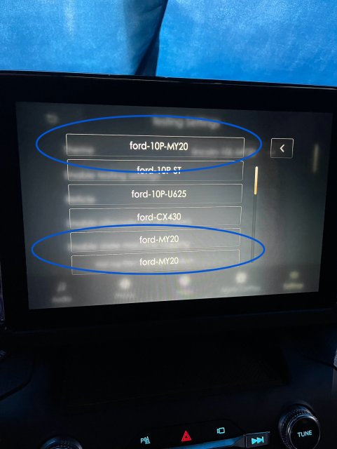

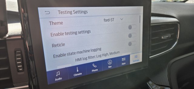

Have you tried to change the Theme?
Push the fast forward button Button (Steering Wheel) and fast forward button Button on the radio for 3 sec.
Test Tone will play.
Push Testing Setting.
You can select about 20 Theme from that menu.
I haven’t yet

When you make the changes in forscan and connect the Lincoln screen it boots up to the ST logo like it normally would do, went it turns off it says Navigator.
powerboatr
718
474
Well thst is strange...must still have lincoln software version in the screen
That’s the one I hate. I guarantee mine will look like it came there….I won’t accept anything less.
I think the only way to make it look like it came like that from factory would be continuing the chrome bezel all around
I tried these one and all it does is turns the screen black out then it comes back to normal after you turn off an on the ignition switch.

I bought the screen, back screen cover ,8 inch screen vents used from eBay. The bottom cover piece for the screen from Etsy all for around $470. I opted for keeping the original bottom piece bellow the screen ( part #LB5Z7813546AC ) and just cutting a small piece of rubber pad, which saved me around $150 that it would cost from ford parts.
