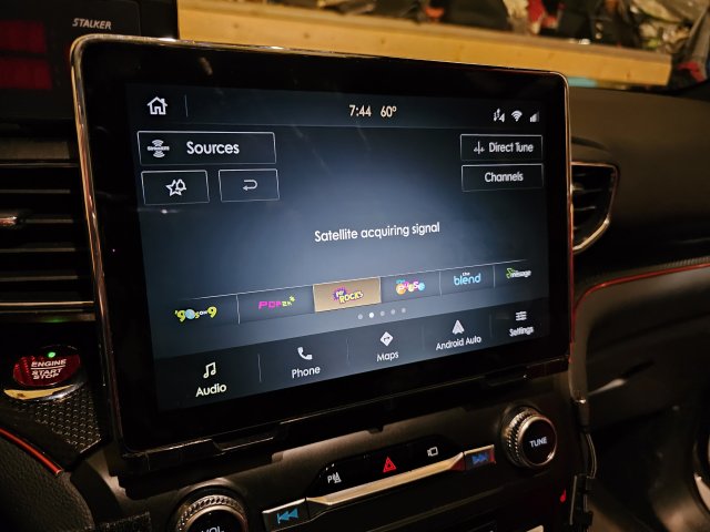

Had to try this for myself. Got a Lincoln Aviator screen for $250 and attached to dash with no problems. 2 simple changes in forscan to make it think it is a Lincoln. I like it 100% better. Everything fits the screen the way it should have been! Seems a little faster response also. Just zip striped into place for now. Will see if someone comes up with a better mounting.

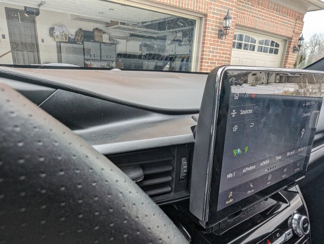

This is a great upgrade even if the ascetics look like garbage from certain angles, the vents from the 8" landscape screen make it a little better they mainly give you better access to the wheels for the vents.
I am hoping the 3d printing guys on Facebook have some decent solutions soon.

is that true ??? Someone posted a pic side by side of the 8” and 10” vents and the 10” vents wheels were further apart than the 8” vents??

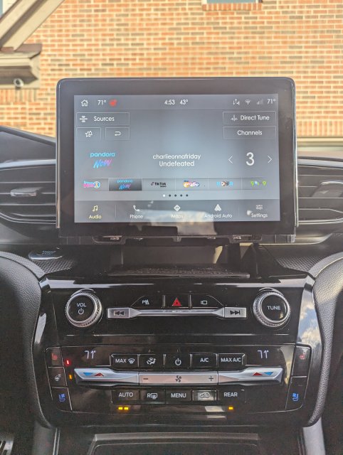

You can change the layout from Lincoln back to ST.
Press the right arrow button on the steering wheel and the right arrow button (Scan button) on the infotainment panel at the same time and hold them for five seconds. A new menu screen will appear.
The setting is under Theme. I have done it couple of time.

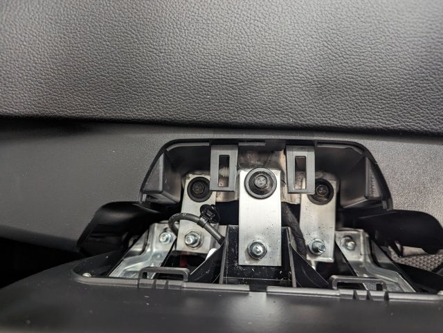

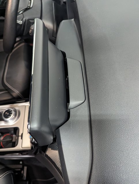

I made the mount for mine out of 1/2" aluminum stock, swapped in the 8" vent trim and cut the original shroud to fit. One of the guys who does 3D printing is working on trim for the bottom, it will look pretty good when done. Saved me from ordering a 25 just for the infotainment system that I hated so much. It's a night and day difference. I did get the screen and 8" trim from eBay.

mount looks awesome!! Wish I had the no how and tools to make that!!
Hope someone can create a standardized mount and bezel kit. Cause I am interested for sure.

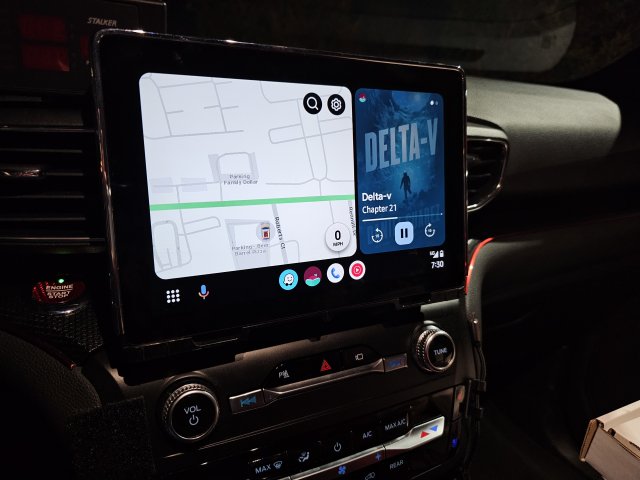

OK, tried this, don't do it LOL. My screen went black and I couldn't see anything, I chose one of the Ford ST ones, the other 10 inch ones are all portrait so those won't work. Luckily the change is temporary and once I shut all the way down and came back it was back to normal. If that didn't work I was going to try a soft reset, with hooking my computer up and using Forscan as a last resort. With this screen you have to change to the Lincoln MY20 10in Visual Design Variant in Forscan and change the brand to Lincoln or you won't have the right perspective and could be missing some menus. I'm not mad at the Lincoln screens though.
