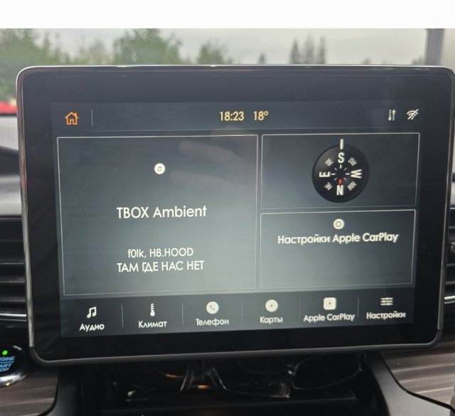

Here's the problem. The number of saved radio stations was not being saved. After starting the machine, I had to go into the settings and adjust the number of stations.

Any idea why it’s only some cars?
I think it's related to the initial settings of the ACM and APIM blocks. In order to display the correct number of tabs, the "Number of presets" and "Mixed mode presets" settings must be consistent. This means that the owners of the Lincoln vehicles with these screens were using a different number of tabs than the machine where the Lincoln monitor was installed. Therefore, this is not a problem but rather a matter of proper configuration.

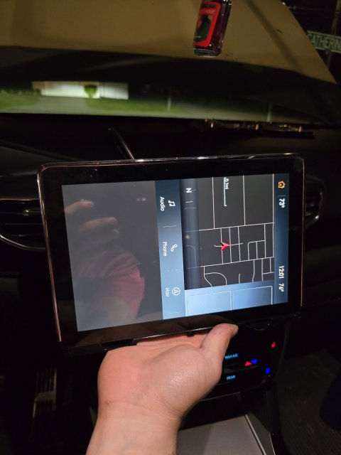

Not sure if I should start a new thread, but I went to setup my Aviator screen, the orientation refused to change. I changed the APIM settings to Lincoln and Lincoln MY20 10in, and its still messed up. Its my first time using Forscan, so I'm not sure if I'm just doing something wrong. Thanks in advance
Lincoln MY20 10in correct setup

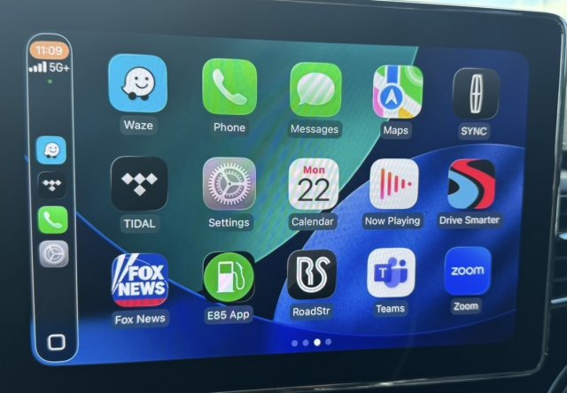

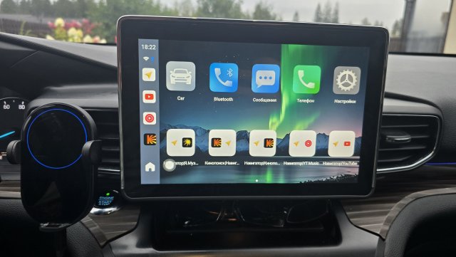

Yes, this screen is much more interesting, and it has a good resolution. I see that you have a chrome-plated frame on all sides. I couldn't find a broken Lincoln screen, so I made the missing part out of a 10-inch tablet case.
5,457
6,543

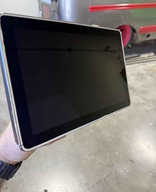

Yea I got together with a buddy at an audio shop and we added the chrome extension and made a smooth bottom for the screen. IMG_7861.jpeg

there is a piece of tablet case at the bottom)

That looks pretty good, do you have a link to the part?
Which Carlinkit did you order?
This is the part of the iPad 7, 8, and 9 (2019/2020/2021) case frame that is glued to the bottom edge of the monitor. CarPlay TBox Ambient, Android 13, 8+128 Гб, Qualcomm 6225
