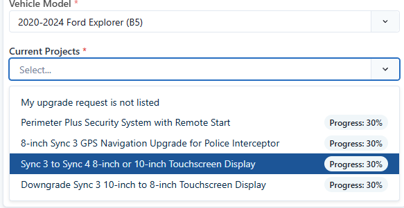

The Sync 4 13.2" upgrade will be here Friday at my house. Will make a new post with alot of pictures. .
***AC vent knobs will be blocked, please don't order if you mind this***
Curious about the blocking of the hvac vent controls. I see from your screenshot there are two options for the system to be upgraded, 8" and 10.1". I would assume the kit for upgrading the 10.1" is adapted to not block the vents.

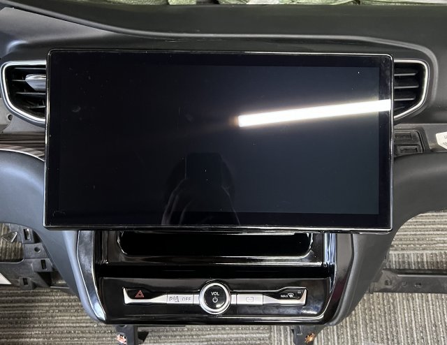

i asked the sync4 guy about how bad the ac vents get blocked...this is the pic they sent...IMO it is FUGLY
485
313
I ask for picture about 10 times. Not to bad.
Im going to print spacer to raise the screen up 3 to 5", Still waiting on my package.

you would think...hmm a place selling the item, would post up many more pictures,
to me it looks LOW and angled odd
but hey its in china
if it was raised to equal the height of the current screen i think it would clear the ac vents better
