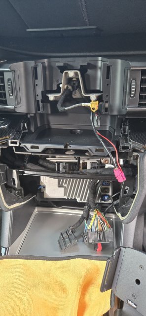

Free shipping and lots of points definitely helps! Also direct from Ford may or may not be priority over dealer orders. I’ll make a bracket out of steel rod for where I want it and I ordered the Etsy lower panel but thinking I will need to improve on that. To be honest, I’m not sure why that panel is needed. I ordered the parts from the write up and I’ll deal with it if I don’t need it. Didn’t want to get into it to find out I needed it. I’ve got way to many repeat trips to the auto store and the hardware in my life to take a chance

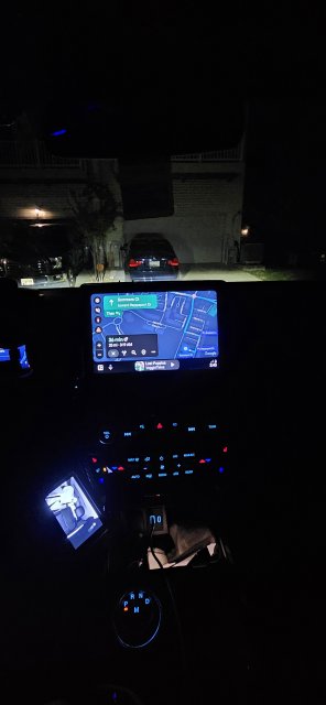

i would really love to see pics of new screen in NAV mode and 360 cameras mode
just as a sanity check to see if the screen is uncluttered with the blue dialog boxes like we have now in the top left screen that blocks a good bit of map

If you go to the first pages of this thread the original guy posted pictures of the nav & rear view camera.

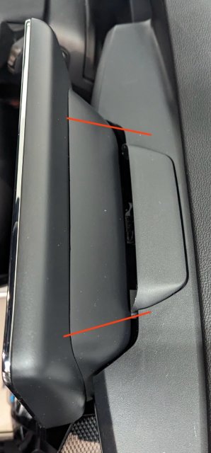

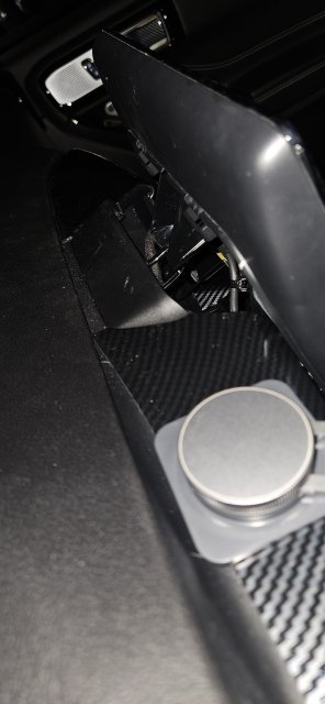

Just did mine with zipties and kept the original trim that it came with. I did have a bit of an issue with the connector, I had to wiggle it a bit to make the screen come on and stay on. I hope it doesn't cut out while driving around.
I don't really mind the gap in the back, nobody in the cabin can see it.

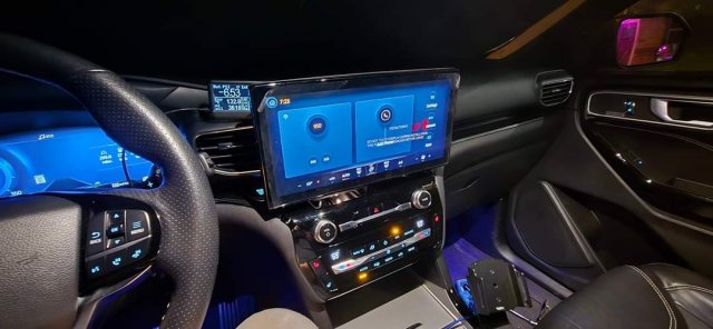

I noticed one bug with the Aviator screen, when I try to adjust the rear climate, I can't see what the settings are.
Does anyone know if there's a Forscan setting to adjust this?
