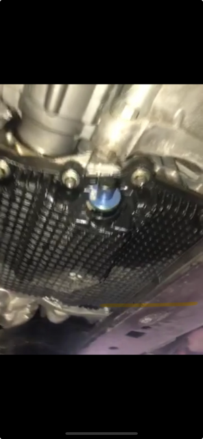

Just dropped mine off for this issue. Also, I noticed either diff fluid or oil on my trans pan. Any ideas as to how it ended up there?

yea the front diff seals leaking. read previous posts

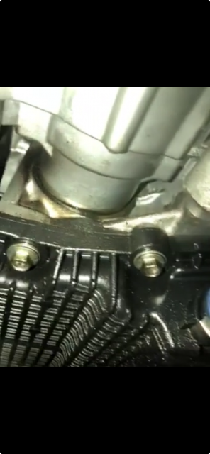

Took in the vehicle for an oil change and they found this! Joined the wet oil pan club @ 40,135 miles. 2020 a build
Unfortunately, with just an oil leak, it seems like dealers are just removing the front axle disconnect actuator and putting in a new o-ring. If I were you, Id push to have the intermediate shaft replacement for the FADA put in instead. Plenty of FADAs have failed and per TSB should be replaced with the new version of the intermediate shaft. this requires a new drivers side axle and awd module reprogramming. Id even offer to pay for the parts if they would install it.
