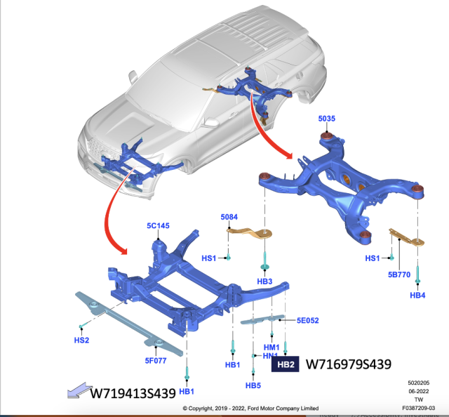

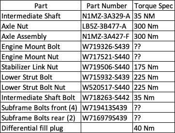

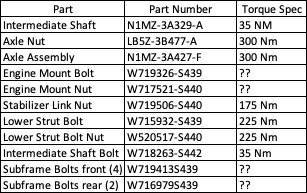

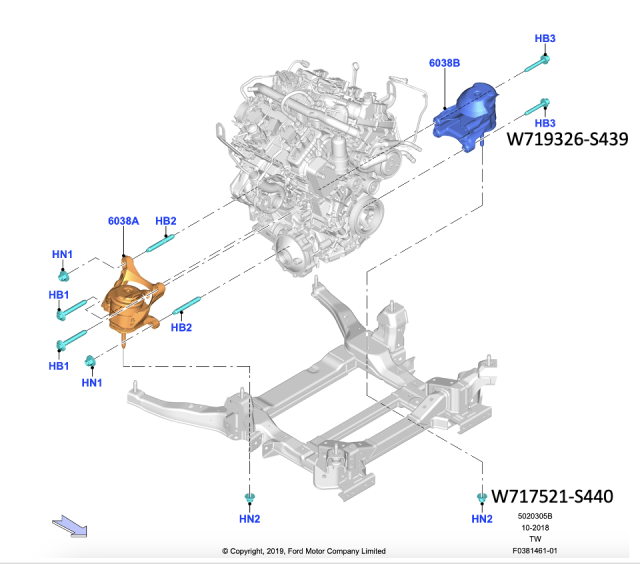

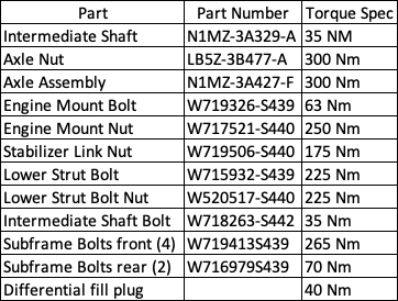

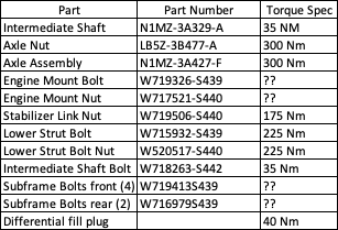

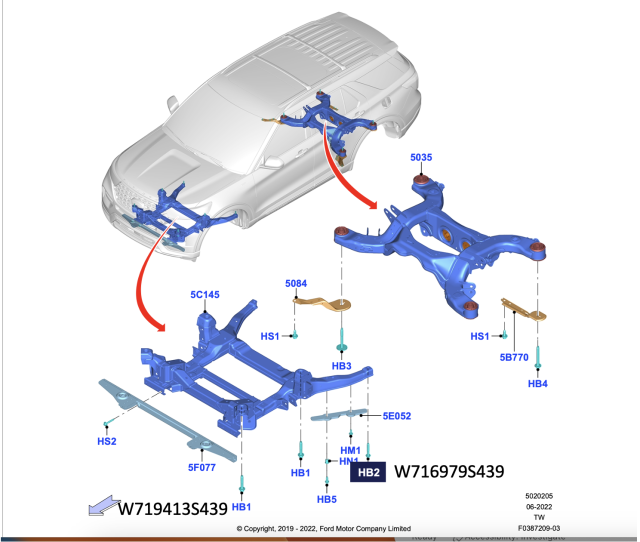

Finally getting ready to tackle this in the garage. Looking for the last few torque specs if anyone has them. Any help would be greatly appreciated.
377
127
Desert South West
Please see below, Instructions are for the Lincoln Aviator, scroll down to the Instillation sections for torque specs.
https://www.liaviator2.com/lincoln_aviator_removal_and_installation_engine_mount_lh-2593.html
https://www.liaviator2.com/lincoln_aviator_removal_and_installation_engine_mount_rh-2594.html
03076
Thank you! The last torque spec for the engine mount nut can be found here with the note that its hand tools only to not damage the mount. https://www.liaviator2.com/lincoln_aviator_installation_engine-2614.html
