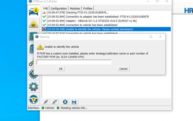

Anyone have this issue when trying to use Forscan? I'm running the Palm Beach Dyno Tune and I have no idea what the Factory PCM number is.

Hmmmm? Sounds like PBD overwrites the vehicle info, so you can't change anything except through them. Not sure, but it sure looks like it. Do you have access to uninstall the PBD tune, make your FORScan changes, then reinstall the tune?
Yep I can do that. Conveniently write is much faster than reading. PBD did a good job with the tune however!

You just need to revert back to stock tune, make the forscan changes, then load the PBD tune and you're all set. after the first time you load the PBD tune, it doesn't take nearly as long to reload it again (~7 mins).

Well I just did this. I returned the car to the stock tune. Used Forscan to turn on the software active noise cancellation and the ACN microphones 1,2 & 3 and changed the country code to WS! Then reloaded the PBD tune. The tune write succeeded but the data integrity check failed. I took the car on a short test drive and it works great. It doesn't skip gears so I take that as it's working.

Yeah, that data integrity check will clear if you reload the tune. It seems to happen on the first load after the computer is in the house. I think it's the internet connection with the HPTuners servers. If you make the revisions right there and reflash even several times, it works just fine. I hate the requirement for internet to load a tune, but HPTuners uses the "connection to log or review every tune that is flashed. I assume it's for their license tracking software...

Yeah, the tune loads to the flash memory in the ECU. So Load, Install, Flash, Reflash, all the same thing. I'm trying different techniques to help prevent the Fail result. I'm thinking that 3 seconds is way too short to allow the car to settle down after the flash process. I waited about 15 seconds after turning the car back on before poking the OK again.

Definetely wait about 15 to 30 seconds. You want that power flushed out of all the capacitors and stuff so no bug in the memory remains. :)

Thanks Zermus and ForzaA3. I let the car sit for 30 seconds until all the screens were completely off after flash before clicking okay and everything completed successfully.
