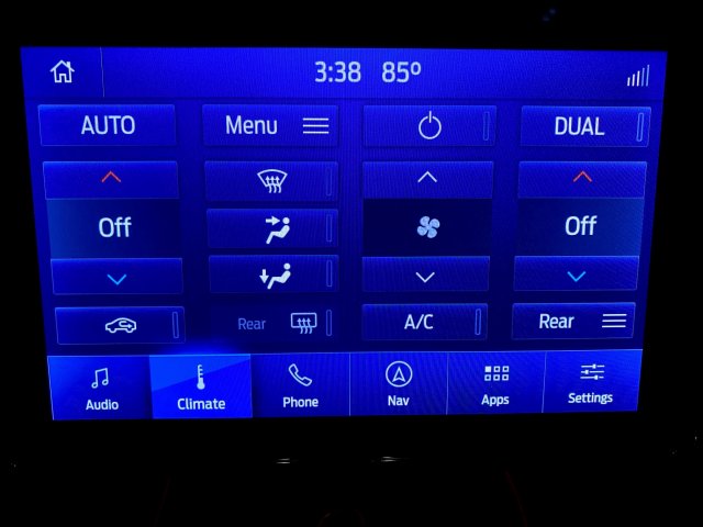

I can't find that ENC setting in Forscan but, while playing around with it I did find a way to add climate control to the touchscreen. It was in the APIM Module and was called Climate Domain. It is disabled so I enabled it to see what it did and I like it, it's more like earlier Fords although it doesn't put up a section like the old versions did.
