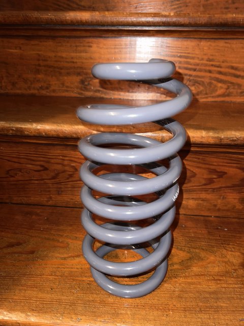

I see exactly what you mean. I'd be interested to see if they have changed the design to more replicate the OEM taper with the new run of them.
If so, might be requesting an exchange.
I just received my set from their latest batch yesterday. As far as the taper goes, they appear the same as yours. The 2nd coil is full diameter.

would you expect any different? Correct me if I'm wrong but they didn't make changes before the 2nd run. They were hoping it was a first run anomaly. it's a shame that this happened. I think the coils on the steeda have a smaller coil diameter than stock. Their initial RSB would rub stock and H&R springs but not the smaller Steeda springs.

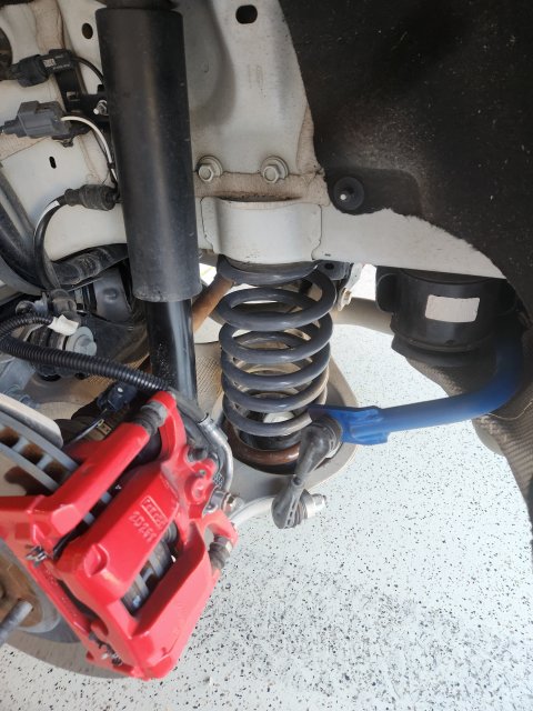

Hey guys just went to get my rear springs adjusted and squeaking noise started again about 15 min after leaving the shop. Has anyone gotten anything resolved or you guys still dealing with the noise?
1,209
607
#64

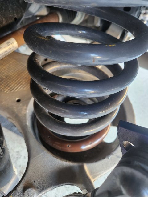

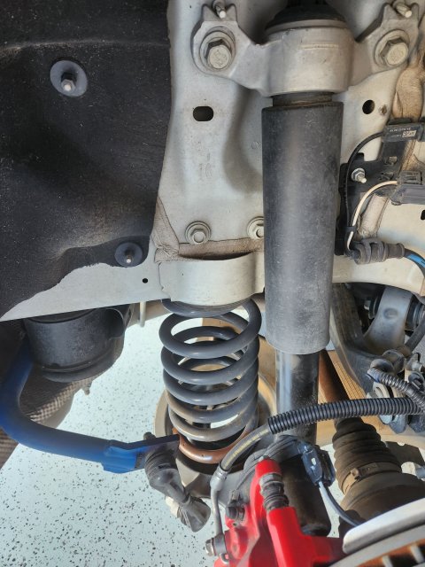

I was able to stop the noise by prying/pushing the bottom of the spring away from the side wall of the control arm seat. It is pretty obvious what part of the spring is rubbing when you look at it. Just use a pry bar to push it as far as you can.
I have noticed that the 3rd coil up from the bottom is hitting the top of the control arm seat top of rougher roads.
1,209
607
#65
Well, guess what is back. The springs in the rear have recentered themselves and now they are rubbing and making noises again. Pushing them off-center only lasted about 2 months. I'm really not surprised that this happened, just really disappointed that Lethal hasn't come up with a solution yet. Need to reflect on what my options are.

Have been communicating with Lethal this morning on a resolution. My patients comes from great communication between them and I from the very start. I need to trust what they are saying, that they are working to get this resolved. The details of this is something Matt and his team are working on and will provide details as they are available.
For now, I will push the springs again and hope it last 2 more months.

That would surely suck. At least now I have more knowledge on what they should look like, measurement wise, before I install them. I may just put some Tien or Eibach spring silencers on the Lethal's and see what happens.
What keeps rolling through my head is that the Steeda's are not as low and the H&R's coil bind in the rears and could make noise when the coils get together. Still not off the table but need to think on it a bit more.

Pushed the springs again today and added some spring silencers on the coils that rub. Hoping this last until Lethal gets some new rear coils made with tighter windings.
