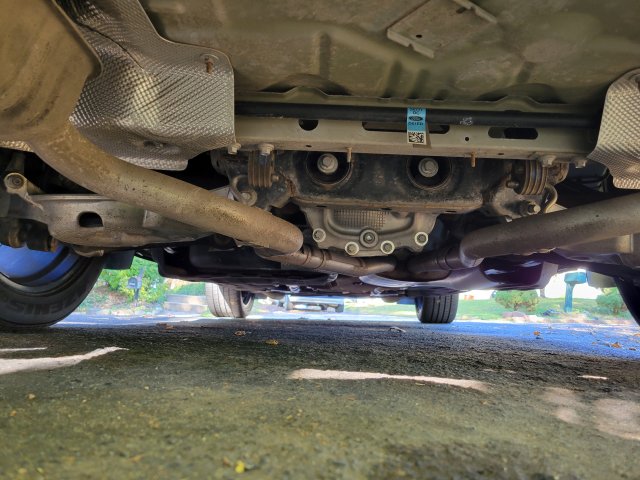

Don't know if the precious owner addressed the recall or if this ST wasn't a recall candidate but it turns out it's a 2/4.
It also seems that what looks like the rear sway bar had been replaced. Anyone recognize it?
The sway bar has a Ford parts tag on it. Guessing it's the factory one.
My 2020 ST didn't get this recall and I've owned it since new. So I doubt yours was subject to this recall.
That's what I was thinking. Stone17 posted a pic on this page that shows what looks to be the bottom of his parts tag. The QR code looks a little different though.
All 2020's had the 4 bolts. That is your original sway bar, mine is the same that I bought brand new. You do have some rust underneath that you should take care of before it gets any worse.
Yes, that was my first look underneath. It will get addressed as soon as I get some time off.
It surprised me in seeing that on a vehicle only 3 years old!
Curiously, I opened the QR code on the sway bar and it turns out, this is a Lincoln Aviator rear stabilizer bar.
