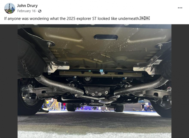

Well, there are plenty of vehicles out there with just one offset rear diff subframe bushing. If their fix does indeed work, I would have no problem with that. I think the 2025's will be telling. If Ford truly believes their fix works, we will see 2025's with the 3 bolt setup. If 2025's come with 4, like the 2020s, then Ford is probably not confident and don't want to dig their grave any deeper. To date, I have not seen any reviewer who attended the 2025 Explorer unveiling look underneath to see how many rear differential subframe bushing supports there are.

I’d like a peek under a 2025 PIU.
