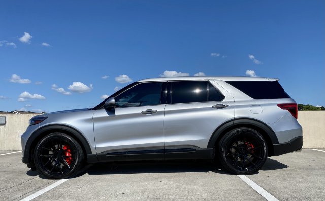

Full disclosure…I walk to the garage at least once a day to take a look…and pics. lol
Gonna order the 380mm rear rotors next week. The rear wheels need a little more meat in them. 9FBBC687-F7EE-416A-BCD6-803187CF169F.jpeg

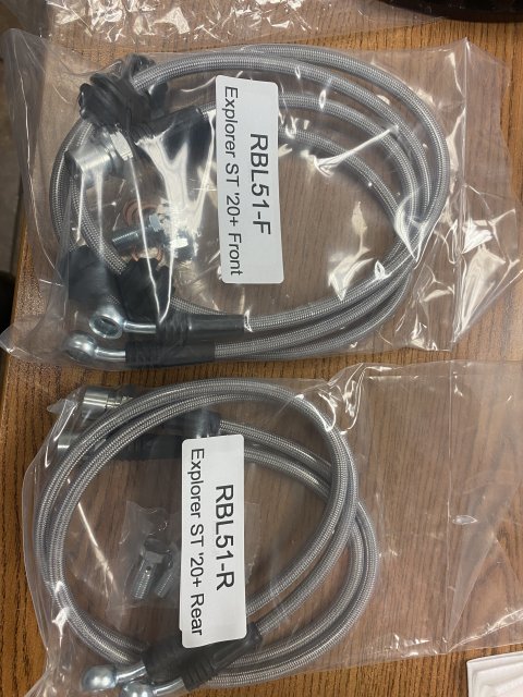

Look what just showed up.
380mm rear rotors, caliper brackets, pads and…FRONT AND REAR BRAIDED STAINLESS LINES!!!! 4F818A2E-3938-4E36-B181-075CDC200580.jpeg 67F2CFD0-7E87-48AB-B24A-58C9953F849D.jpeg
1,511
So, does this mean they are now supplying braided lines which also have the right "tangs" in place for the calipers? Also, for the rear, are these replacement calipers, or just brackets that relocate the existing calipers to fit the bigger rotors?
