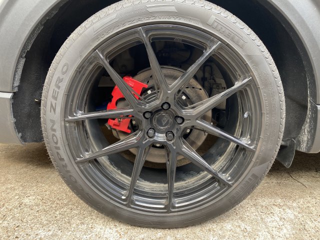

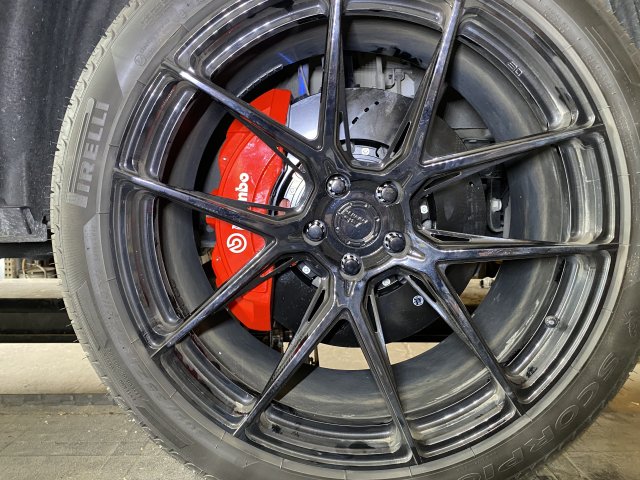

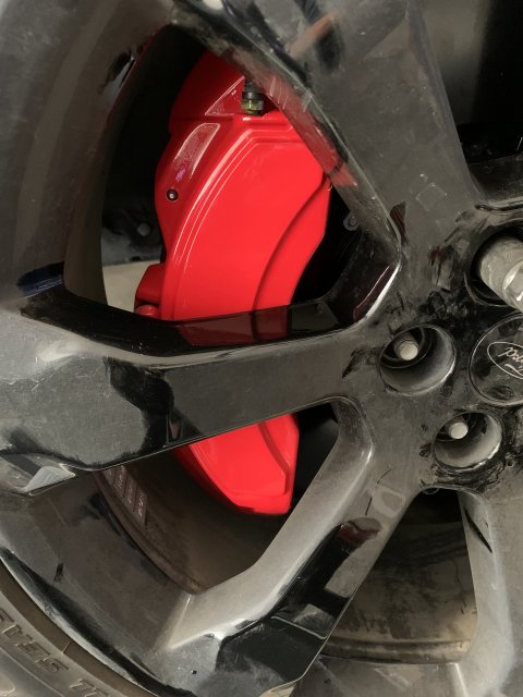

Now the thing I see will possibly be an issue with oem wheels...these calipers are huge. I have aftermarket forged wheels that are cut for a big brake kit and I have about 3/16” clearance on the inside of the spokes. It’s close and I just don’t know how the oem 21’s are cut since I don’t have them anymore. Someone will have to verify fitment with those wheels. BDDB11CC-9C62-4E7A-8958-973EA7F53624.jpeg FD1BFF36-892F-4963-8B54-9E5783EF917A.jpeg CF5B8757-9FC4-4DCD-98BC-42A667751FE4.jpeg

I sure do wish you still had the stock 21"s available to check fitment. Of all the mods I've seen this is the one I'm most interested in, but am not really looking to swap wheels.

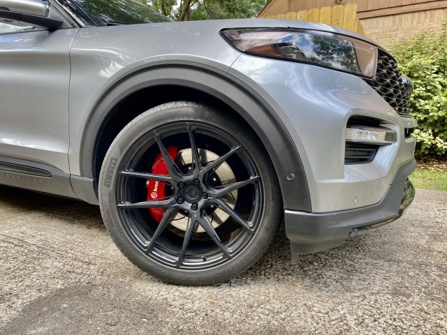

And a couple of filthy car finished pics. 7C0140A0-C901-425B-8D4B-6245F6E69B21.jpeg 37D2010B-3EA9-47EA-A5A3-9900DE016C21.jpeg

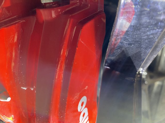

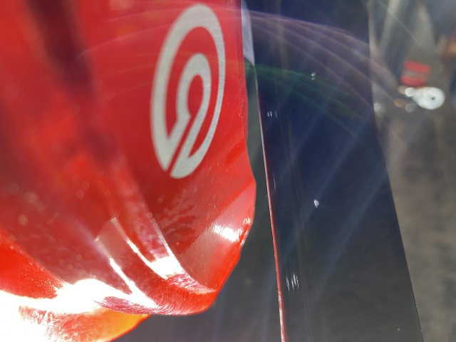

So... it looks like about a millimeter or two need to be shaved off the caliper to work with the stock wheels. I will most likely pick up a thin spacer.
