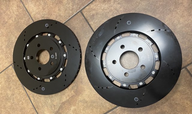

Rotors are out for delivery but these look sweet too. 9238CDE3-11F2-48CA-820A-48BEF5B0E8C6.jpeg

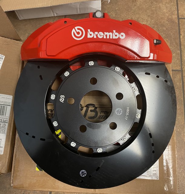

Game time. The parts look stellar, Warren. 375ABA27-6EA0-4389-8499-79EE8A12A1B8.jpeg 3AAE328C-A9A4-4B3B-85F5-2B463E5749D0.jpeg
