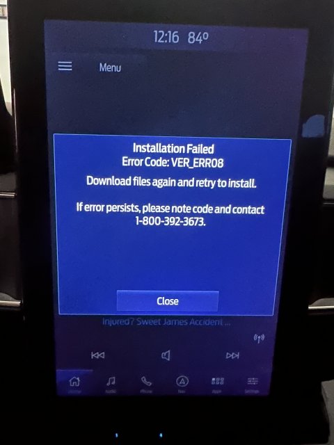

So I’ve gotten this error message twice today when trying to do the update via USB. Went back, deleted the files and the initial download, redid the download and moved files to USB, tried it again and got the same message. Trying it one more time today.

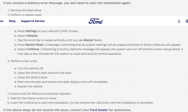

Try following these directions from Ford.

Tried two soft resets back to back and then attempted the update. Same error message. From what I understand that error is from not enough memory to complete the update and the soft resets should clear that. I tried a master reset but after hitting continue the screen just sat there. I’m gonna try the soft resets into a master and see if I’m able to perform that. Then I’ll try and do the update again.

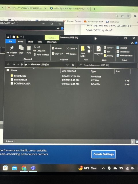

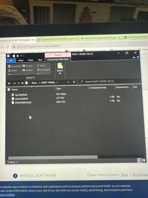

Make sure ALL the files from the file extraction made it to the thumb drive.

The 23188 update USB has a script to clear RWDATA if it is full. You sure the update USB is version 23188? You really shouldn't be running into VER_ERR08

Definitely 23188. All the files that downloaded, all extracted to the usb. Not sure if I’m doing something wrong but I also was under the impression it was supposed to clear the rwdata so I’m extremely confused as well.

So I’ve tried the update via usb another 5 times over the last two days with zero success and the same error message as the end result each time. I’m going to clear the files from the usb and download them on my work desktop and transfer a new set to the usb. I’ve done probably 20 soft resets and still can’t even get a master reset to complete. When I attempt a master reset the screen just sits with the continue button selected and the screen frozen.
Anyone have any suggestions on where to go from here?

Call the number, 800-392-3673, on the error screen. Ford will help you through the issues.
