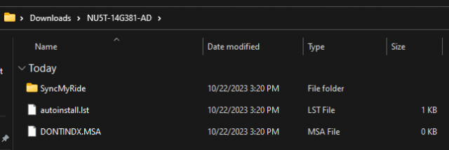

It looks like you opened the SyncMyRide folder.
You should have 3 files.
SyncMyRide
autoinstall
Dontindx.msa
Should work from there.
ilovest
Seattle
SyncMyRide
autoinstall
Dontindx.msa
Yeah I know about the 3 files. I was actually talking about the SyncMyRide folder. From the screenshot that I replied to, it shows 8 files in there but mine only 6, hence the question since my st is not starting the update even after leaving the usb stick plugged in for over 10 min.
Only 6 files in mine.

Yours is failing right? For me, it does not even start. My truck does not even recognize the usb stick it seems.
Did you try it with these 3 files?
SyncMyRide
autoinstall
Dontindx.msa
Or the 6 you posted?
ilovest
Seattle
SyncMyRide
autoinstall
Dontindx.msa
Those 3 are there and SynMyRide out of those 3 is the folder which contains those 6 files. I didnt muck with any of the files. I was just curious since I saw 8 files in that screenshot. So i thought that was my issue and thats why was checking with you guys to see if my zip file was corrupted somehow. But looks like it is not. So the issue is something else.
