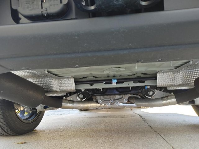

As far as install, were you able to get both sides to sit in the same position front to back? for whatever reason, my passenger side sticks out more than I'd like...a good inch to 1.5 inch past the driver's side. I followed the instructions with the cuts and made sure to deburr any fragments that might prevent the Axleback pipe from overlapping the stock pipe.
jrgoffin
372
305
The midwest
Thread Starter #82
As far as install, were you able to get both sides to sit in the same position front to back? for whatever reason, my passenger side sticks out more than I'd like...a good inch to 1.5 inch past the driver's side. I followed the instructions with the cuts and made sure to deburr any fragments that might prevent the Axleback pipe from overlapping the stock pipe. when it gets warmer, I'm planning to cut the stock pipe another inch to get the end of the Axleback to sit an inch forward.
Funny you mention that since I noticed something similar, but maybe only half inch or so. The muffler on that side was a lot harder to slide on, but I figured it was just tolerance differences of the factory piping. Having the adjustable tips made it easy to line it up, but assuming I acquire the new factory pipes, I’ll test fit and maybe cut a hair more off the one side. Otherwise, no complaints at all.
EDIT: I just carted off the stock mufflers for scrap, and was curious about something first. It’s hard to tell in the picture, but with my eyes, I could see the cut point was slightly different on the passenger side. I’d say anyone would be safe to cut at 2” from the bend line on that side or go down to maybe 1” on the driver’s side so both muffler assemblies would line up more exact. I’ll definitely look in to it soon enough when I acquire the new factory pipes. My cuts were slightly at an angle, but you get the idea. Might even be worth mentioning to Gibson.

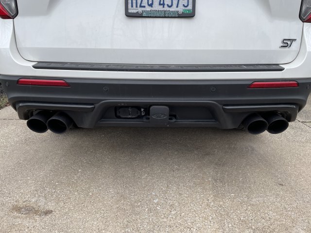

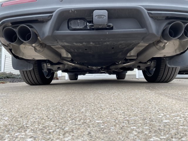

Thread Starter #83
I'll definitely look at it again when I have the other kit on the ground, but from memory, mine lined up the same way. May not matter with the bend, but I did also notice the hanger on the passenger side being closer to the upper bushing bracket. Probably just as safe to stay with the 1.5" cut like Gibson specifies. No noise for me, and with the tips lining up nicely, it will be awhile until I mess with it now that it's getting cold outside.
EDIT: Also, with those band clamps (Evil Energy from Amazon), the bolts that come with them are junk. I bought some Grade 10.9 M10-60 flange head bolts and nuts and used them instead. In the event I have to adjust the clamps or loosen them and re-tighten, I don't have much faith in those cheap steel bolts.
Looks good in any case!
