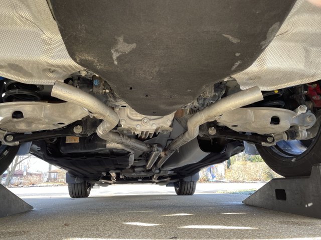

Finally got mine installed today since it was relatively nice (well, if you consider 40° and sunny nice). Great sound, but with the MRT H-pipe, it’s a bit too loud for my tastes, so I’ll have the factory resonator welded back in sometime shortly.
Install was pretty straightforward, but I need to go back and re-adjust the driver’s side tips since they shifted as I was cranking down the band clamp. Overall, probably took less than two hours since I was in no hurry at all. The directions don’t mention it, but you’ll probably have to remove the rear upper hangars so you can lift the ends up after you slide the pipes on to the factory tubes. They are a pain to get at, but easier without the factory mufflers in the way.
Quick shot after breaking out my recip saw - no turning back now:
Finished look, but I’ll re-adjust the tips whenever warmer weather rolls in:
I’ll attach a couple video clips once I figure out how to do so (imagine it being just a bit louder than the video clips @Cdubya posted at the top of this page). I did get in a quick drive and it has a great rumble, with no drone even with the H-pipe. I'll be glad to tone the decibels down a bit, but I can live with it temporarily before I swing over to the local exhaust shop.
