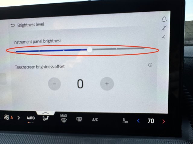

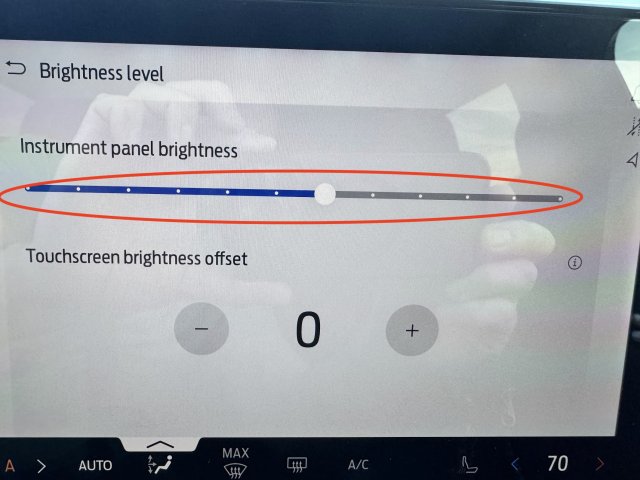

Just sent in two data logs. There is some learning to the app and I lost a couple logs by pressing the stop button too many times. Odd my oil life indicator immediately went ot 0% after first load of tune. Also, the infotainment display is going up and down in brightness and the UI changes.
The first photo is how it is normally, it changes to the second picture on its own and the brightness changes. Lets hope that gets resolved.

I have not seen anything user-related with the tune load. That's weird.
