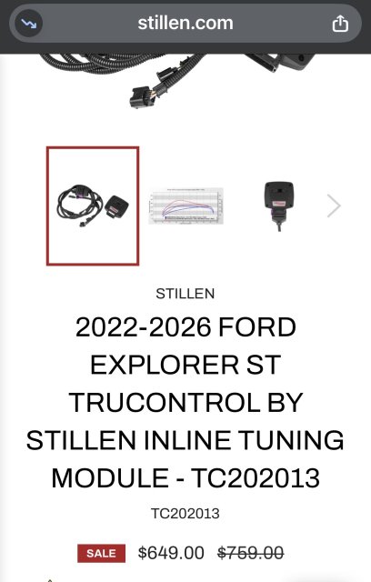

#79
Anyone know anything about this unit and Company…?
1,922
1,637
#80
Pretty much the wrong thread to be talking about another manufacturer's tuning device. This thread was to discuss ZFG's tune.
