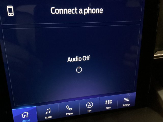

Okay guys… I need your help! Got everything installed and wired up but it won’t turn on? The radio says “power off” and won’t turn on. I have 12v at the LC2i and both amps… I have checked the fuses mentioned in other posts (amp fuses #115 and #127 & ACM fuse #32) and all are good. Does the LC2i need a remote in? I figured it would auto sense… Any guidance would be greatly appreciated!

You saying the oem head unit will not turn on?

It turns on but the radio doesn’t turn on… it just stays audio off.

Gotta be a loose wire somewhere imo. I assume pushing the on/off button sends a signal over the can bus to the oem amp telling it to turn on.

If your audio won't turn on in Sync, it has nothing to do with the LC2i which has auto-turn-on by default. It sounds like your ACM isn't working. Can you pull codes? Did you mess with that at all? Where did you pull you signal from?

I only have my ZFG tuner to check codes and there weren’t any that it saw. I pulled my source wires from the sub inputs and ran those to my LC2i. When I plug the power in to the controller the yellow “maximized” light will come on for a second and then turn off. I can get the “power“ light to come on if I do a 12v jumper in to the controller but the radio still does not come on? I will redo my lead wires to make sure they are correct and properly joined.

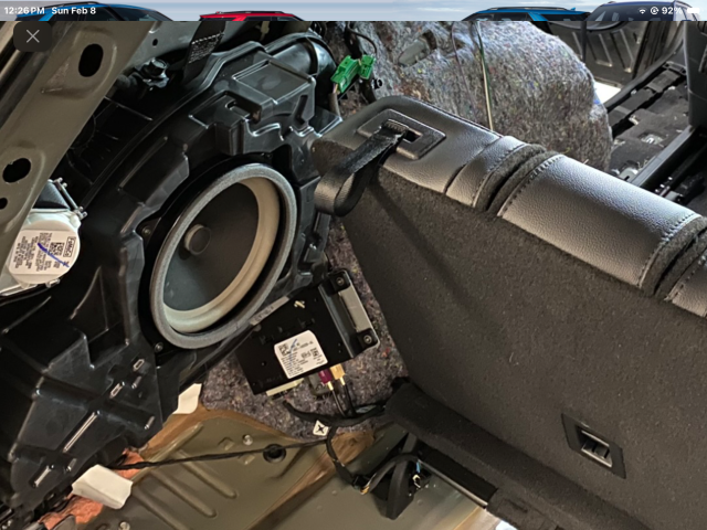

So I re-did the connectors from the sub input wires to the LC2i and made sure the were + to + and - to -… same thing radio says searching and then goes to audio off. What is the box below the sub inputs to this picture and do I need to disconnect the tan and maroon connectors?

When "audio off" is displayed on Sync, it has nothing to do with your LC2i at all since those are completely separate from the infotainment. Maybe try rebooting sync or even pulling the battery ground for the car to reboot.

I pulled the negative and waited 30 seconds and reconnected. Still says audio off… when you say rebooting sync do you mean do a factory reset? If not how do I reboot it? Couldn’t find that as an option in the menus.

If you are just taking signal from the subwoofer input, then the system is almost complete separate from. I say almost because it can detect if the speakers are not connected. Maybe the ACM detects no speakers are connected and is not even attempting to play. But the real problem is that your Sync is saying "audio off" and not with the LC2i which is probably not turning on because it has no input signal to turn it on. May do a scan with Forscan? If I temporarily disconnect a speaker, it will log that the speaker is not connected.

Make sure you didn’t knock a plug loose on anything in that area. If the factory amp doesn’t kick on the radio will display Audio Off.

But with what you did, there should be no reason for "audio off".

Pretty sure you need to leave the factory electronics intact: ACM, DSP/Amp

Well if that’s the case then that is the issue… I will put the amp back in and see if that works.

Plug the factory amp back in. If you removed everything and added amps and only used an LC2i you did about half the job. You should have used an actual interface to remove the amp but keep all your chimes and such. You would also have a better input signal than just tapping a few wires.
