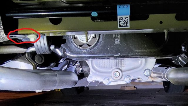

They kind of in a way admitted fault , the Lincoln aviator uses the same subframe and they all have the 2 rear bolts on them, they were not recalled. Im honestly curious did people with the correct subframe get the recall through the Ford app?
My 2020 has the two bolt (four bolt) and no recall….yet anyway.
