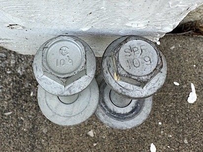

new vs old:
W720988-S439 on the left.

So, same grade, same geometry..... just from a different manufacturer?

They are exactly the same. 10.9 is a spec itself and has minimum requirements. These bolts are identical and nothing has 'changed'. Ford marketing and management is trying to change physical for the sake of their checkbook. You Mr fireman are welcome to shill for them till you are blue in the face. The fact of the matter is a real fix is exactly why you bought a diff brace. The absolute irony of your purchase and refusal to remove it after ford 'fixed' the issue for you is not lost on us.

You are correct Cdubya, the bolt is the exact same as the other. They are both 10.9 rated and when manufacturers are given MINIMUM requirements they will always meet the minimum without going over.

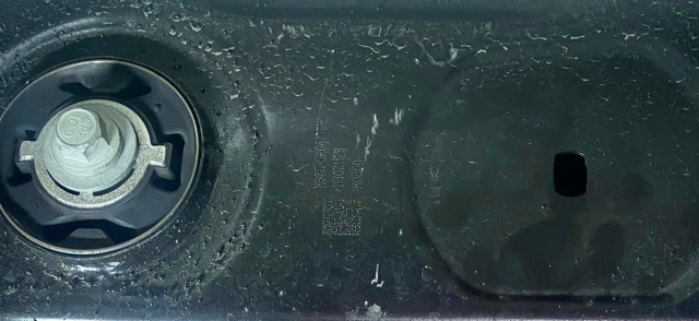

1,977
1,002
This is the pic Mr. Fireman posted (of his own mount?). Interestingly, it shows the new mount but instead of the "upgraded" bolt, that there is the old "SPF 10.9" bolt! Now if Ford really thought the new bolt (W720988S439) was "upgraded" would they have put that old one in there? Old bolt, new bolt... probably doesn't matter because it's the same bolt as far as specs. As long as you're getting a new bolt, that's all that matters. If I had a 1 bolt, I'd be buying a few of these bolts and replacing it yearly. If anything, to check to make sure it's not bent. Ford does not recommend you reuse these bolts so if you check it, you should put in a new one--even if it's not bent.
