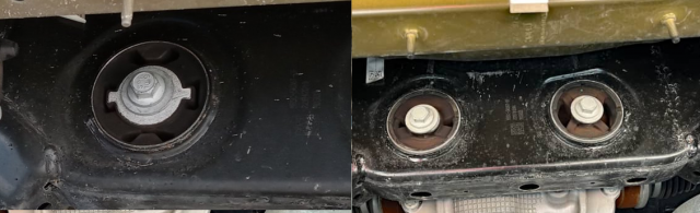

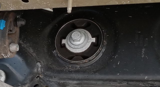

So I did some research, here is what I found:
  • my ST was built one day after the recall cut off date per the latest 23S55 bulletin, so technically, my vehicle should have the fix
  • checking further, I put my VIN into both the NHTSA/FORD recall page, no recalls exist for my ST
  • still not believing it unless I confirmed it visually, I went out and took a pic (see below)
  • confirmed, I have the upgraded bushing
Wow, some good news for a change. lol I'm tempted to remove the AWR brace, but I think I'll leave it on for now.
(p.s. the first ST I purchased in April 2022 shows as currently being under recall by NHTSA/FORD)

Regarding the comment: "what we have here is FORD using a solid bushing (that from the pics I've seen, is the same one that came on the 2/4 bolt rear subframe)".........
The "revised bushing" for the fix doesn't look anything like either of the original bushings on the 2/4 bolt cars. While the metal center section on the new one is "solid", the bushing itself certainly is not.

Now to address the new bushing & bolt. Based on this new design bushing, it appears to a knowledgeable person that Ford thinks the root cause was the sheer angle not remaining perpendicular to the fastener centerline such that it wasn’t subjected to a pure sheer load resulting in the bolt bending at the max load location. After it was/is bent, its load carrying strength was/is severely degraded, building more angled load momentum until failure.
The new bushing, being much thicker with much less rubber cushioning, will attempt to keep the load in pure sheer which will indeed strengthen the mounting. I obviously don’t have the sheer load rating of the bolt, but the new bushing is designed to correctly utilize that load rating.
