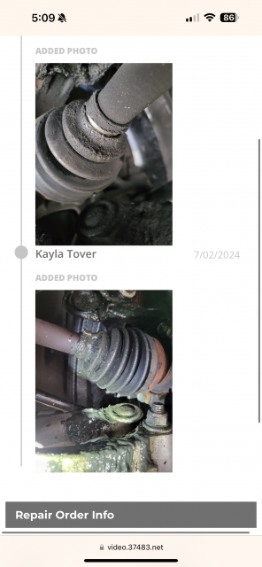

Just had this newer recall done. They drill out the bolt holes and put in larger bolts and for some of the bolts they get reinforced sleeves added as well. Got it back to do the oil change and after so many posts about the drive shafts I looked under and sure enough th passenger front was torn open and the entire suspension was covered in grease. Dealer said they didn't see anything while doing the other work. Then realized he meant to tell me that they only checked the rear end with the work they were doing and i'd have to bring it back after I sent him a picture. Maybe this will be last time for a while...lol.

Well, I feel pretty fortunate cause the dealer got me taken care of today. Got it in same day and replaced both front axles. 40k and both axles…what a trip.

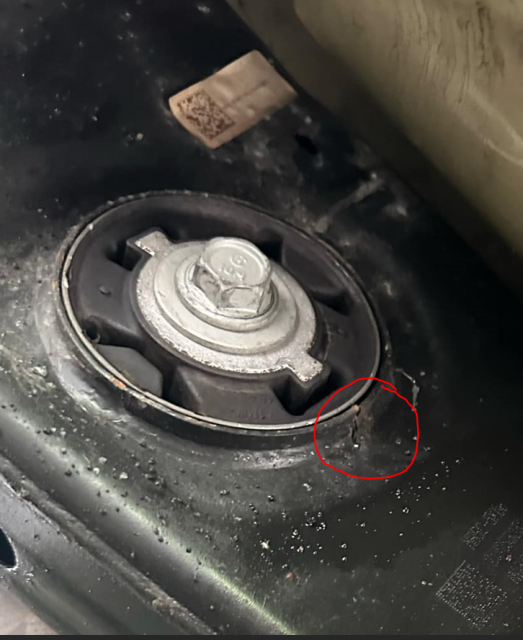

Newbie here. How concerning is this crack? Being told by a local dealer that this is fine and that another dealer that did the recall recently must have cracked it replacing the old bushing.
FORZDA3
502
344
Gloucester, VA, USA
Its “fine” until it isn’t. It may last a lifetime or a short time, bur either way you're gonna pay.
Its likely ok, just something to watch. There’s not a terrible amount of stress there, but its cracked so ANY stress will concentrate there.
