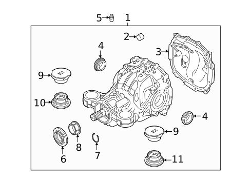

When the rear axle rotates under hard accel the pinion climbs upward. Having a horizontal bolt to hold the axle housing in place is just asking for trouble. If you look at the diagram on how the rear axle housing is mounted, there are two ears on either side of the pinion snout that has two rubber bushings and a vertical bolt.
If you replace parts 9, 10,and 11 with stiffer delrin bushings, you could limit vertical movement of the pinion snout and could reduce or eliminate the chances of bolt failure. Throw in a super strong bolt in the back where they break and an acceptable fix could be done for less than $250 in parts.

... If you replace parts 9, 10,and 11 with stiffer delrin bushings, you could limit vertical movement of the pinion snout and could reduce or eliminate the chances of bolt failure. Throw in a super strong bolt in the back where they break and an acceptable fix could be done for less than $250 in parts.
$250 x 252,936 Explorers = $63,234,000
Not including labor.
