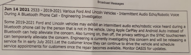

Did you get any details of what we would ask other dealerships about to validate this? I personally don't trust dealers and what they say if it can't be validated
Ford stated: " The big fix was replacing the APIM. If it persists, there is nothing else hardware-wise for Ford to replace. The next steps (if already fully upgraded to the latest build #) is to wait on Ford to push the fix down in an upgrade. Probably a month out." See the Broadcast Message below.
Ford's Service Mgr did provide the number to Ford's consumer affairs hotline 800-392-3673. I think if we all call in on the same issue and expect restitution, perhaps it'll be an avenue to a permanent fix. UPDATE: Case No. CAS-32103368-T6Q9N8 
I'm guessing your dealerships said the same?
