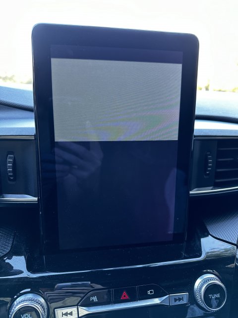

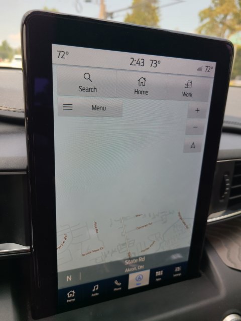

Is anyone running into this issue? The Navigation screen on my 2020 Explorer shows half blank.
The screen works fine, shows things on the other menus - just get a white screen when on navigation screen. Also, on the home screen, no navigations maps show up - a blank white screen as well.
Took it to the dealer yesterday, and they were stumped??
Thanks!

Yup this is one of many issues with this system for months now. Oddly, once a week or so lately I get a full map then next time it's back to bottom half of screen! The Sirius Travelink weather radar map also only shows bottom half of screen.

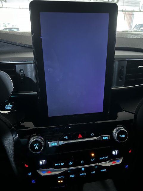

Please do. Mine is beyond ridiculous at this point. Besides not having a full map, my entire screen will just be blank half the time. If I go into reverse, the top 1/3 of the screen will be blue gray until 25 mph then turn gray. Yep. That weird. Wi-Fi doesn’t work, Bluetooth won’t connect at startup, can’t turn radio off, and the list keeps growing. IMG_1899.jpeg IMG_2308.jpeg
