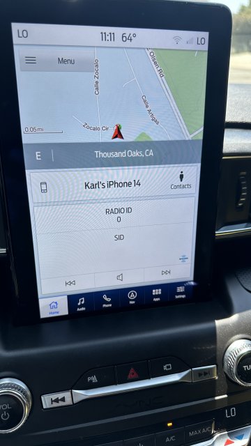

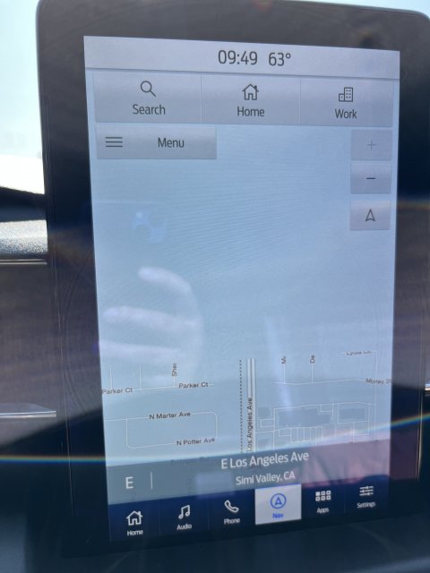

Hey Guys,
lately I’ve been having issues with sync — not remembering phones, nav screen only shows half of a map, doesn’t start off on the last music station, etc
Any suggestion on issue or should I take her into service?

Welcome to the club! This issue has been annoying me daily since April! Consider yourself lucky if you're not one of the people who has been screwed by their Ford dealership who tried to charge them $1000 or more to replace the APIM out of warranty. I'm not even gonna pay my deductible because this is a memory loss issue caused by the latest Sync software update. Thouasands of owners didn't all of a sudden have failed hardware. Ford's software messed up our hardware and they need to fix this ASAP. A master reset is a temporary fix and so is replacing the APIM. It will eventually run out of memory if you are running Sync 3.4 version 22251.
