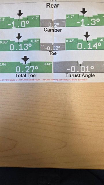

So fixed the toe on the rear, again checked the camber and this is what I have with the weight off the wheels and maxed out in the slots. Not sure how you guys are getting it to -.5 in the rear for camber (without dremeling the slot) but this is the best we can do for my ride. (And yes we did the adjustments according to the info and diagram.) Not complaining though it looks good enough for me. Thanks for all the help everyone I appreciate it.

You may have one of the anomaly cars like mine that need to have the slots lengthened. I’ve seen less than 5 like that since these cars came out.
