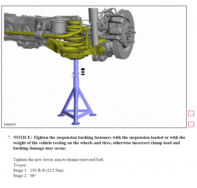

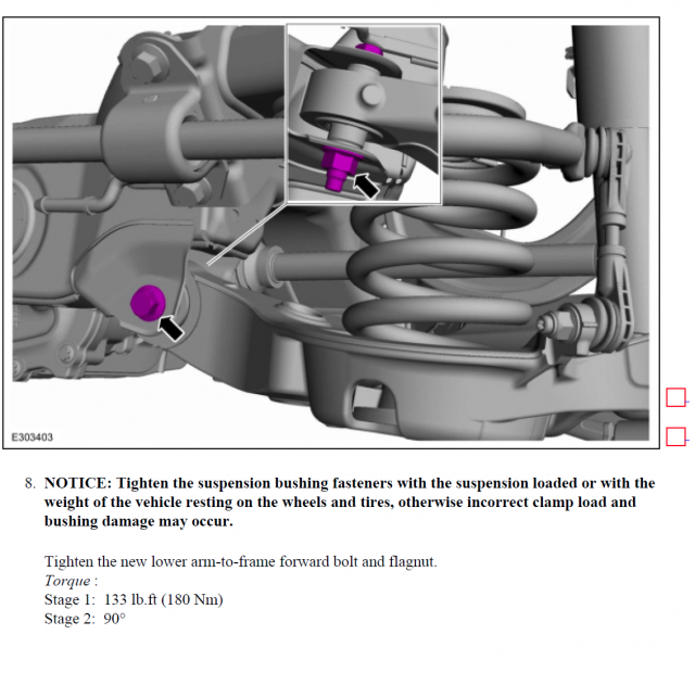

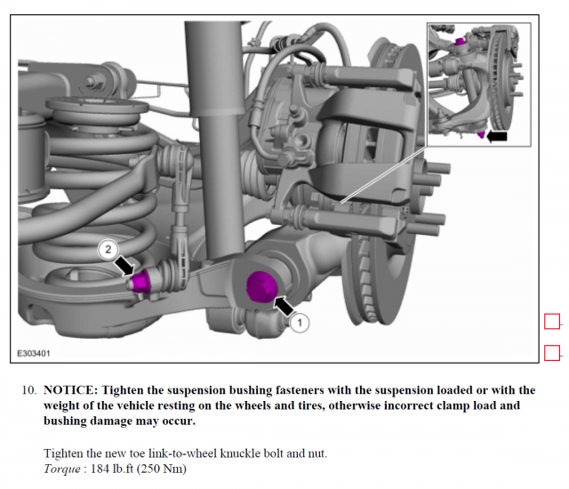

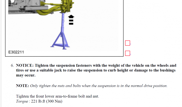

What are the lower control arm mounting bolt torque specs for the steeda springs? The instructions say to look up those manufacturer specs. I just can’t find them. I think the guy that installed the springs and sway bar tighten those bolts while I was up in the air not on the ground.

thanks so the lowers are 66 ft-lbs and 180 degrees
only the rear is squeaking, maybe not enough lube on the swaybar too? i wish the steeda bar had zerk fittings to add grease :(
Sorry I didn't see where you specified front or rear of the vehicle. It's gets confusing because the front end has both front and rear control arms.
I don't know if one or all of these apply to your question.
