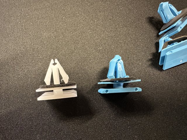

Btw, if you break the clips for the rear trim where the camera is, I wasn’t able to find a direct part number for that clip, but did find something similar.
Ford p/n W716352-S300
I bought a pack of cheap Amazon knock-offs which seem to do the trick.
Michigan (Detroit Area)
#29
Thanks, man. Much appreciated!
