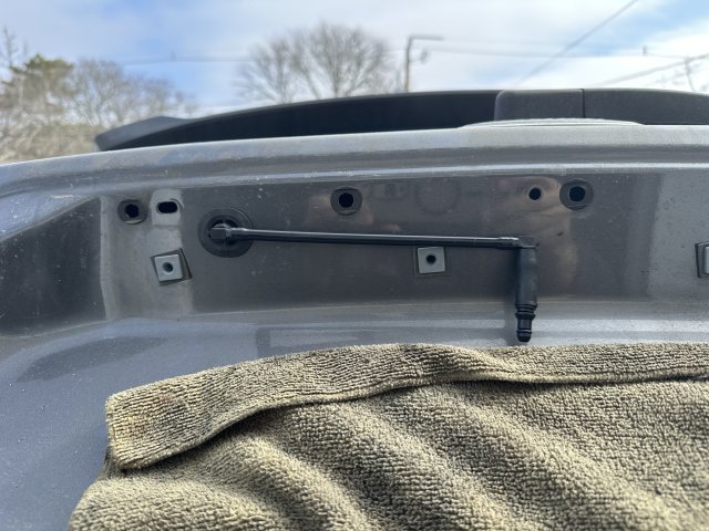

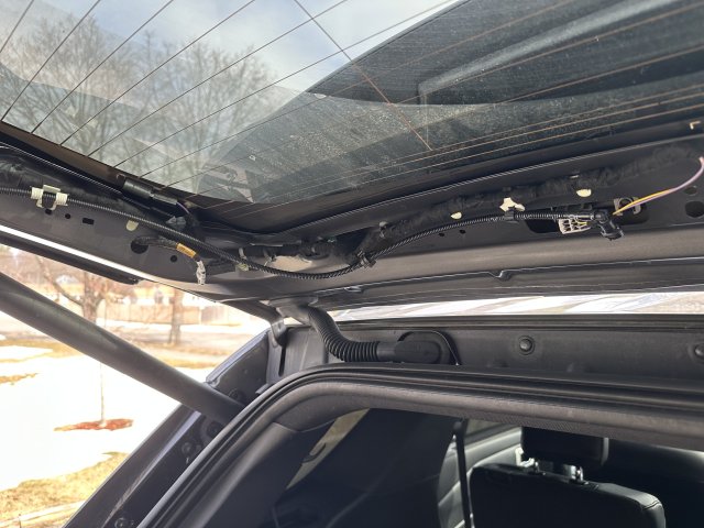

Finally got around to installing mine. Ran into a bit of a snag.

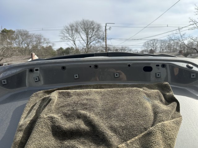

mine is a late ‘23 and seems to not have the hole/grommet that is specific for the washer fluid line to pass through. I was scratching my head for a few mins wondering how the fluid got through before I realized it’s just not there.
hate to drill through, but looks like that’s my only option.
i was expecting this

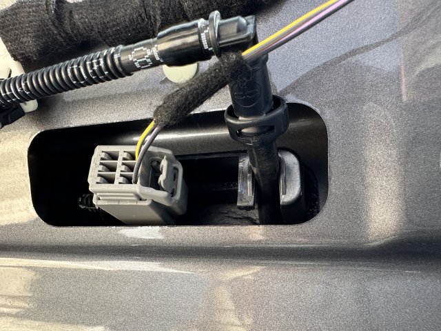

And instead I have this. The grommet above would be located on the left hand side and is not present on mine.
My camera is different as well from the OP's, but the part the washer nozzle clips onto is the same. Just the electrical connector is completely different

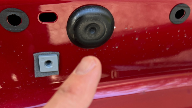

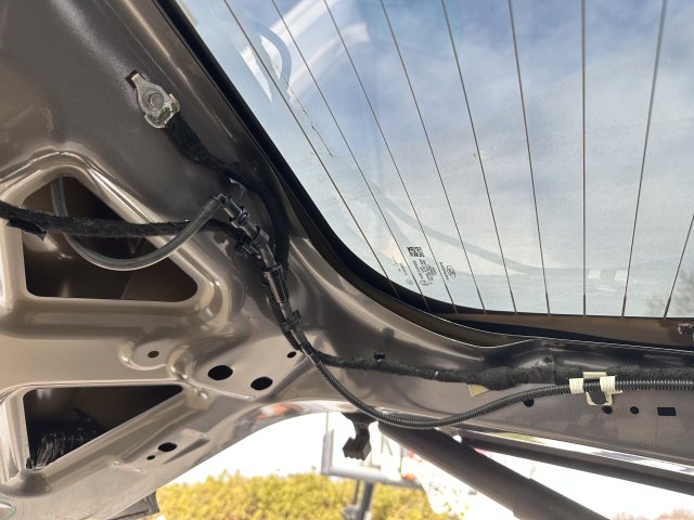

Well, ended up not being a big deal. Carefully estimated where it should be based on above pic and drilled a 1/2" hole. I then used a stepper bit to ream the hole slightly larger and oval it out left and right. Only took a few seconds to do so go slow and check fit often. But grommet went in nice and tight.
But this step took me all of 5 mins. 1/8" pilot hole. 1/2" 2nd hole. Stepper bit maybe down one step, and enlarge left and right slightly. Go slow, start small and test for seal. I wanted the grommet tight.
This is p/n LB5Z-17A605-AC installed

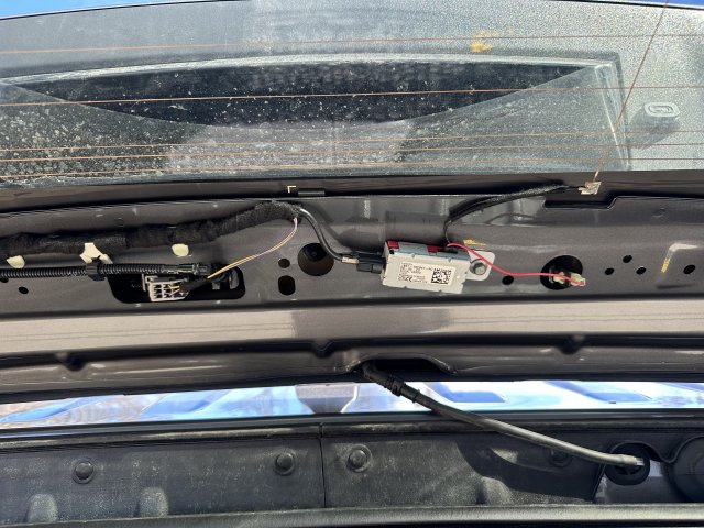

Took a couple more pics to show the routing of part number LB5Z-17A605-W along the liftgate of the 2nd washer fluid tube. All the clips and mounting holes were present so this was plug and play. Decided to save the Y-tube install in the spoiler for a different day.
The camera will have a block off clip mounted on it that is essentially a dummy washer without the hose. The part number for this dummy clip is LB5Z-17603-J just in case anyone needs it. But you will remove this clip and install the new sprayer hose the exact same way.

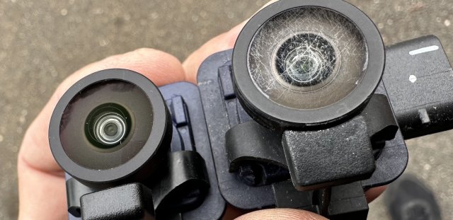

If it makes a difference to anyone here, I’d argue that not having the washer setup cost me a camera due to having to wipe the salt off it all winter.
See this thread for camera replacement info
Rear Camera Replacement | Explorer ST Forum

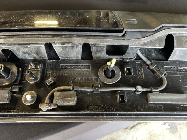

Couple more pics that might help folks doing this. Tackled the spoiler today, which was the hardest part of the job and why I saved it for last.
3 10mm nuts hold it on. One in the center and one on each end. After that it’s 9 or so clips which are a royal PITa.
first, use a phillips to remove the two clips holding the pinch sensors. Once remove carefully pull away and release the two clips underneath. One on each side. Photos in the first post in this theead
Once those 2 clips are released and the 3 nuts are removed, just the 9 PITA clips remain.
First, unplug the brake light on the left, the small red wire on the right and disconnect the washer connector. The red wire was a big pain to get disconnected.
after that, pull hard to release the clips. This was the hardest part. I thought I was going to break the spoiler at times with how much effort it took. Eventually it released. I only broke two clips. They are very similar to W716352-S300 but I think the base might be a little wider. Might be a different clip. Sorry I didn't get pics of the clips to compare.
Once removed, here’s the old line for reference as you will find it. Disconnect the line at the right side and remove. Install part number LB5Z-17A605-E like shown in the first post.
Reinstall the spoiler. Carefully position and then use an open palm to slap the spoiler down to seat the clips. Make sure the two clips for the wings are secured.
Finally reconnect the electrical and washer lines. Here’s the detail showing how the washer line will stick out and connect to the line on the hatch.
