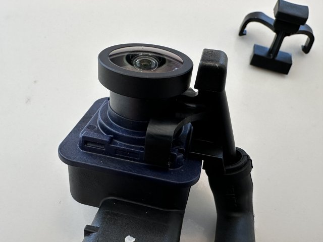

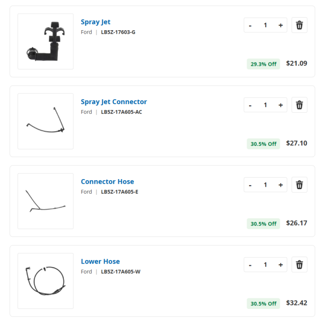

This is p/n LB5Z-17A605-AC installed
Took a couple more pics to show the routing of part number LB5Z-17A605-W along the liftgate of the 2nd washer fluid tube. All the clips and mounting holes were present so this was plug and play. Decided to save the Y-tube install in the spoiler for a different day.

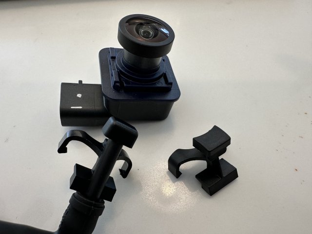

The camera will have a block off clip mounted on it that is essentially a dummy washer without the hose. The part number for this dummy clip is LB5Z-17603-J just in case anyone needs it. But you will remove this clip and install the new sprayer hose the exact same way. IMG_0364.jpeg IMG_0365.jpeg

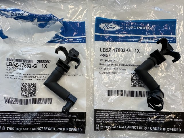

Also, double check your parts. I had to order the spray nozzle twice from Ford because despite the right part number, i got the wrong part in the bag. Left one is wrong. Right one is the correct nozzle after ordering it again. I had this all apart and was wondering why my hoses wouldn't connect up. Had to put it back together and order the same part again
