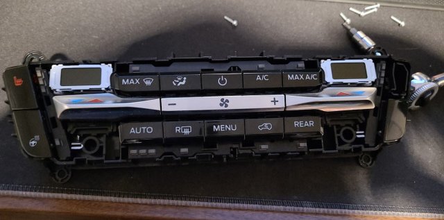

Bought this off Ebay for $100 shipped. I took it apart last night. Just to look inside it.
Going to install it today.

She working.
Back up the old HVAC As-Built and reflash to the new unit.

You should be golden.
You will need a Torx to remove the A/C Unit from the bezel. I used a T-20 its alittle loose but it worked.
