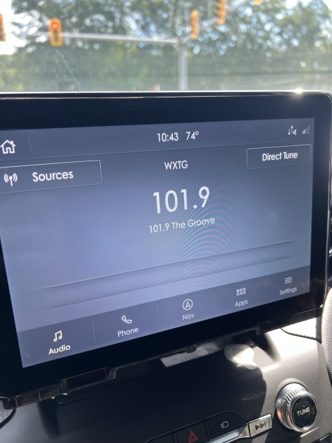

If there are any Forscan experts out there, let me know if I should try something. Also how do I get a free trial again after the initial one expired

Forskan doesn't help, and the engineering menu doesn't help either. I've made an agreement with a specialist, and he's going to make a Ford update that can be installed by hacking the sinc. However, there is a problem with the saved radio stations. After a long period of inactivity, the car resets the number of preset radio stations and doesn't recognize them. I have to go into the menu, set the number of saved station tabs, and then they appear on the screen. Yesterday, I tried to solve this issue using Forskan, and we'll see if it works today.
sorry, I don’t understand. Where do you see the number of saved station tabs? Using Forescan?

Wow, I guess I need to pay for a fore scan license and check this out!
if I'm not mistaken, this can also be done in the trial version. By the way, I dug around in the evening and found another parameter that may affect this issue. The settings did not reset within an hour. I'll check in the morning and tomorrow to see if it worked.

The problem with displaying saved stations on the screen has been solved. If anyone is interested, please write to us. Forscan is required for the fix.

Mine and many others display saved stations just fine. What issue did you uncover?

Here's the only issue that I have. Can't save radio channels.
Here's the problem. The number of saved radio stations was not being saved. After starting the machine, I had to go into the settings and adjust the number of stations.
