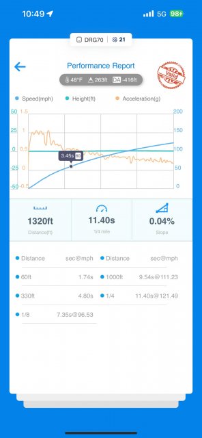

Little update on this car. THAT MPH!!
You can see there is a good 0.05sec in just the launch! So it will get even better. Weather still isn't the best.
Some guys are in the -2,000 to -4,000DA which is absolute best case perfect weather. This customer will hopefully get better weather.
E50 tune, E37 fuel (stock fuel system)
STOCK TURBOS
STOCK TRANSMISSION
CVF intercooler
CVF downpipes
Thermal R&D 3in
H&R springs
Stock scorpions
454
219
20 Platinum
STOCK TURBOS
STOCK TRANSMISSION
CVF intercooler
CVF downpipes
Thermal R&D 3in
H&R springs
Stock scorpions

Well....I'll just keep updating this thread with quicker and faster times I suppose! :D
This car is toying with the Fuel System cars in WORSE DA, while going faster than most (more power).
Crazy to see how far these ST's have come on the COBB Accessport platform in just a single year! Everyone who has made the switch to COBB has mentioned how much they love it!
