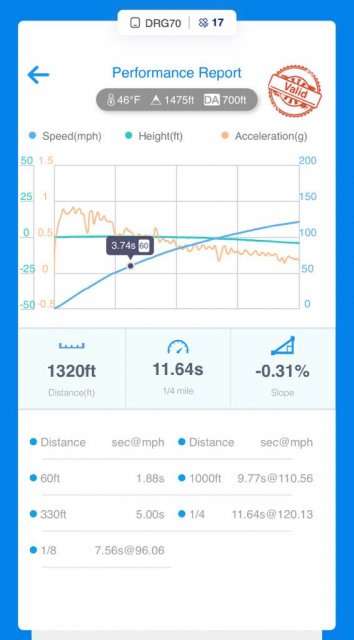

Another ST we tuned!
This car will run 11.3s on a good launch, 1.88 60ft isn't the best.
E50 tune, FBO.
These cars are really starting to move! With some better conditions this car will go even deeper 11s!

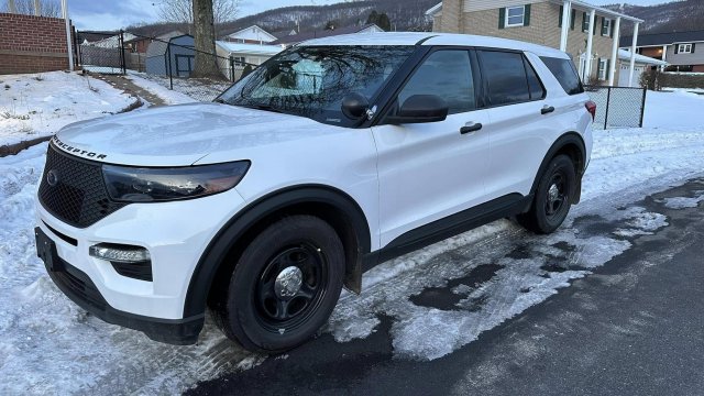

Tuning a buddies Explorer PUI 3.0 on HPTuners (since COBB doesn't support it).
129,000 miles, 100% stock, 0 mods, 93oct
See stock dragy below. Keep in mind this stock dragy is absolutely in the best possible conditions and one of the strongest stock dragys I have seen, ESPECIALLY from a Police Interceptor!

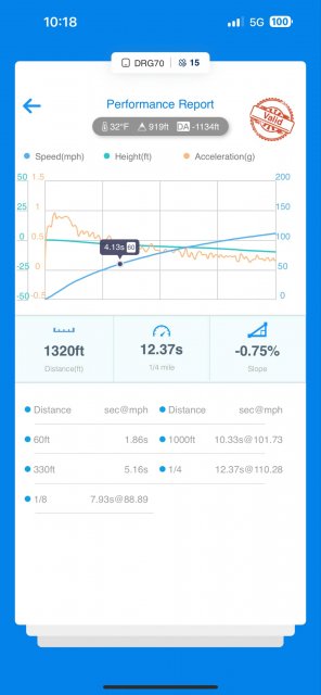

GooseTuned
265
340
New Mexico
Thread Starter #185
And here is the car with my tune, second revision. Picked up over 100whp and pulled off over 1 second from his ET!!

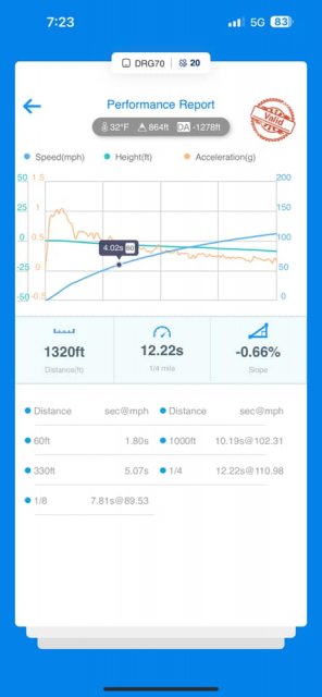

Update on the stock Police interceptor I'm tuning on HPTuners!! 111mph!!
Still some work in the 60ft, but as you guys can see we might hit 11s on 93, out of a STOCK PUI! :cool:
