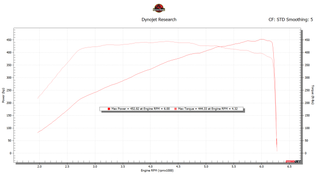

I was able to spend a TON of time on the dyno launch day! To date I've done close to 600 pulls in this ST. More than half of it's miles are EXTREME testing miles.
2023 ST
CVF Intercooler
FenFab Intake + piping
01/11/2024
Dynojet 424xl Dyno
Stock: 354whp 430wtq
COBB OTS 91oct: 383whp 437wtq (+30whp)
Goosetuned 91oct: 436whp 450wtq (+82whp)
Goosetuned E50: 473whp 468wtq (+119whp)
I think that's pretty good for the first day. I can't wait to see how things go after having used the software for 4-5yrs.

Maybe a silly question, but why does your dyno run of the stock Ford tune show ~50lb/ft more torque than others tuners stock runs. Then your tuned torque numbers show virtually no improvement over stock, compared to other tuners dyno sheets.
GooseTuned
45
52
New Mexico
Thread Starter #15
I am at higher altitudes so the car will make more boost in order to hit load targets. 2-3psi more than other sea level guys.
I am currently limiting load (boost) at the lower end and ramping it in to keep torque flat.
This past week I've been doing a TON of tuning, so I'll be posting some more dyno charts shortly!
May have found even more power on 91 :cool:
