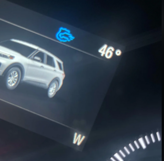

Does the tune retain the pursuit mode that activates with aggressive driving holding the gears to keep the revs up. It is lots of fun when the blue horse light comes on the dash, the vehicle thinks it is party time.

...is lots of fun when the blue horse light comes on the dash...
Help me out here, it's the first time I've ever read this.

It doesn't look like a horse, maybe that's in a different model. Looks like it's just sport mode for interceptors.
Sorry the first time it showed up on the dash I looked at it quick . Badge with PIU. The interceptors have had this feature for years just did not have a light come on the dash.

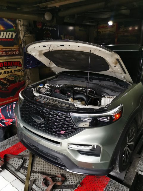

I would like to share my personal experience with Goose’s tuning.
First of all, the results are simply outstanding and truly impressive. The process is very professional and delivers exactly what is promised. The datalogging and revision process is extremely fast—Goose responds in less than 24 hours.

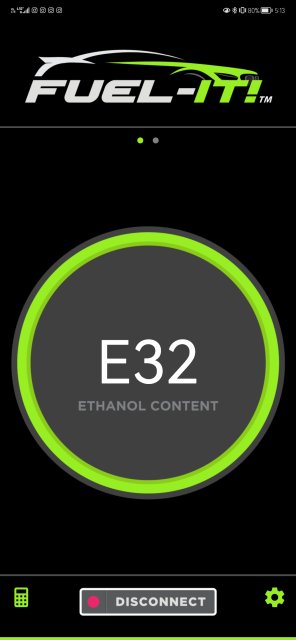

In my case, it took about two and a half days to find the ideal ethanol blend, mainly because my injectors reached their maximum capacity at just 30% ethanol. As a result, I currently run between 30% and 35% ethanol.

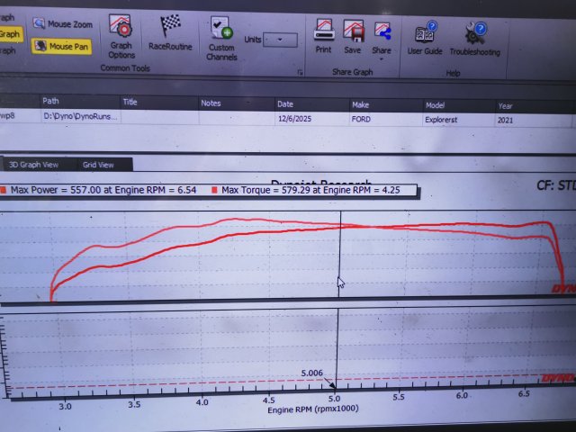

The change is absolutely brutal: going from a 330 whp baseline to 557 whp (Dynojet). We are talking about an approximate gain of 227 whp, which is simply incredible.
100% recommended. The use of COBB is very straightforward, and the overall experience has been excellent. I am truly grateful for the support and results.
Dynojet STD
557.00 WHP
579.29 WTQ

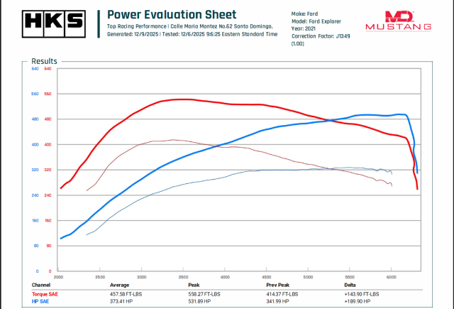

Mustang Dyno (Load Base) SAE
Baseline Stock
341.99 WHP
414.37 WTQ
GooseTuned E50 (E35)
531.89 WHP
558.27 WTQ
Tropical Ambient Temp 86F ~ 90F
