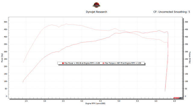

Something of interest you guys may want to know, those of you who dyno!
Got a car on a a remote dynojet last week that was *NOT LINKED* meaning the front tire speed and rear tire speed differs. The car HATED it. Threw AWD errors and reduced power.
The car still however made 440whp but wasn't happy doing it. Really choppy chart. A couple times it cut power down low, then added it back. Once we got it off the dyno everything was 100% ok. Looking at the chart you can see it is not smooth, this is due to differing wheel speeds.
Lesson learned: Some cars are more sensitive than others when it comes to an unlinked dyno. To be safe, LINK the dyno when possible!

This is an important fact to keep in mind since many transfer systems don’t handle significantly uneven speeds well. That’s why there have been cases where AWD or 4WD systems struggle on dynos when the rollers aren’t linked.

Very true!
