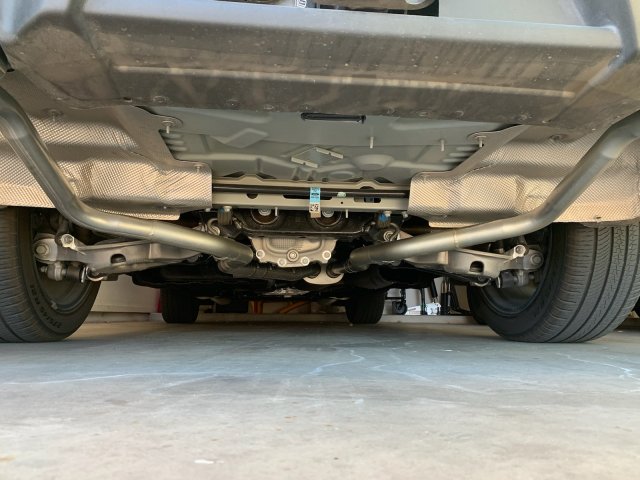

So i removed the OEM resonator and replaced it with an internal x-pipe resonator . Removed the rear mufflers and added straight pipe with some tips....other than the typical round tips ( so tired of that look ) .
I will have to get a video up soon but i can tell you right now that this was less than half the cost of Borla and sounds absolutely amazing . No drone and subtle deep tone at highway speed . After you jump on the accelerator , it really growls .

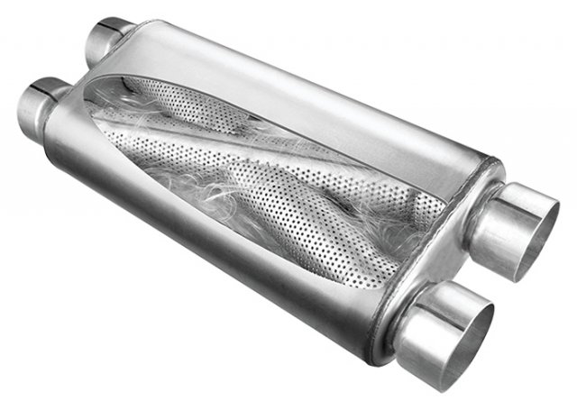

Would it be possible for you to post the make or part number of the internal x-pipe resonator you installed, thank you...

Can you take a couple of underneath pics?
Probably the one from DynoMax since there aren't a ton of others out there.
The OE one is offset, so this one may not fit since its inlets and outlets are centered. Having an 'X' welded in will probably be easy enough as an alternative.

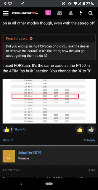

Did this the other day, no more speaker exhaust sound!

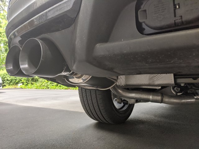

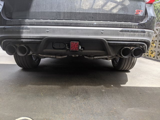

So Monday I did a OEM muffler delete and straight piped the exhaust with some new tips on the end.
I would just like to mention that exhaust sound (note) is subjective to each individual. (like music, food, movies etc)
What I observed (and heard) is that the exhaust sound was louder, raspier and I acquired a bit of a drone at 2000-2300 rpm. Did not like the result at all...
So today I went back to the custom muffler shop and had some Vibrant 1140 2.25 Ultra Quiet Resonators welded on just before tips.
Huge difference... Rasp is gone, drone is gone, just a nice even deep tone through the whole rpm range. And it's plenty loud without being ubnoxious under full load. Again this is my personal taste.
This whole exercise cost me aprox $450cad(I live in British Columbia Canada).
It is not a Borla SS custom system but unfortunately here, with the $ exchange, customs, duty, shipping I'd be looking at $2000cad to go the Borla route..
