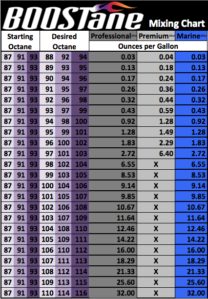

It doesn’t take much...especially if you’re just trying to get 91 up to 93. Over mixing is just wasting it. 68B9E625-FF4B-4158-BA13-90FAC2CBA2C2.png

Nice. So many options to choose from. I think I will go with the 93 tune and add an octane boost tune.
