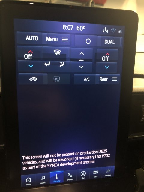

Is there a way to show the climate controls on the screen?

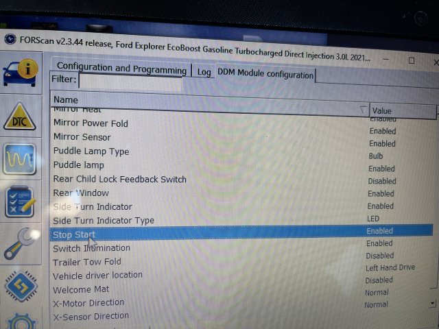

Messing around in Forscan and found this Any idea what it is? Hesitant to mess with it since the vehicle is up on the rack.
D063E1C4-EB5A-48BA-863D-812BF5957C48.jpeg D063E1C4-EB5A-48BA-863D-812BF5957C48.jpeg 88B19D92-7E7E-4657-9E3F-557AF9AE6F3E.jpeg 88B19D92-7E7E-4657-9E3F-557AF9AE6F3E.jpeg
